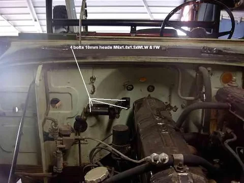

I need help with pictures if possible of what all goes through and on the firewall. I have a lot of holes, boxes full of all sorts of parts, wires and cables. I know the dash side, lots of posts on that. Cannot find much on what goes where and through the firewall. This is a 1962 fj40 that came to me already disassembled so pictures will help a lot. My parts came from 3 different land cruisers and I think some non land cruiser parts also got mixed in. A man's puzzle I guess. Will be fun trying to sort all this out.
I have tried to put red dots on the holes with numbers next to them. Some I can figure out, most I could guess at, but if I can get what they are will be a lot less trial and error.
Pictures of how the brake lines and clutch line, wires etc were routed would also be great.
1 hi lo shifter rod
15 parking brake cable
7 12 volt power socket
6 & 13 wiring

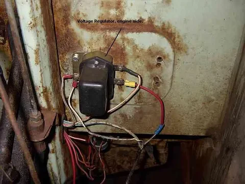

24 voltage regulator location
9 & 11 aftermarket heater
14 horn relay location.
I will have to dig a couple of mine out to figure more out for sure
