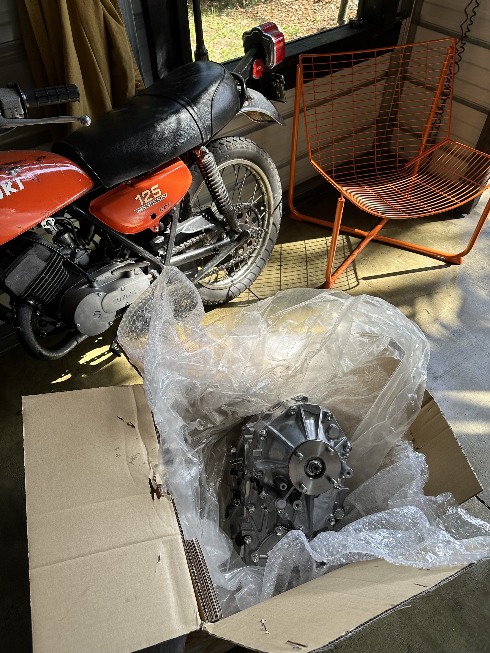

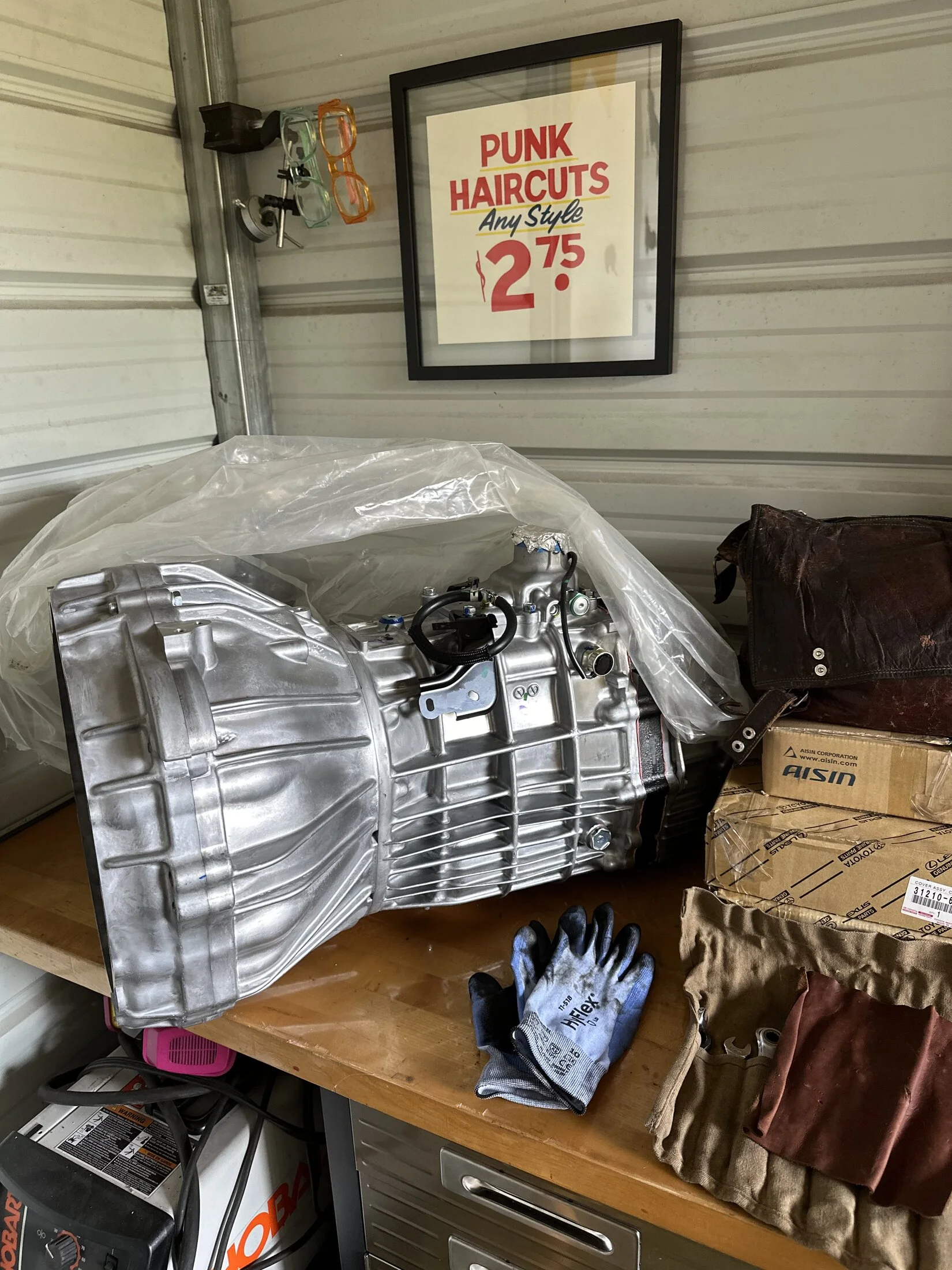

I have a bit of a project going on with a UZ motor/h152 transmission/70 series case... Having a little trouble tracking down some torque specs. Ive tracked down all the parts just need some final specs to bolt it all up.
I'm after...
2uz Flywheel bolt torque specs
2uz Pressure plate to flywheel
2uz 2 piece bell housing
2uz Bellhousing to transmission
Ive been hunting around the web for awhile with no luck.
