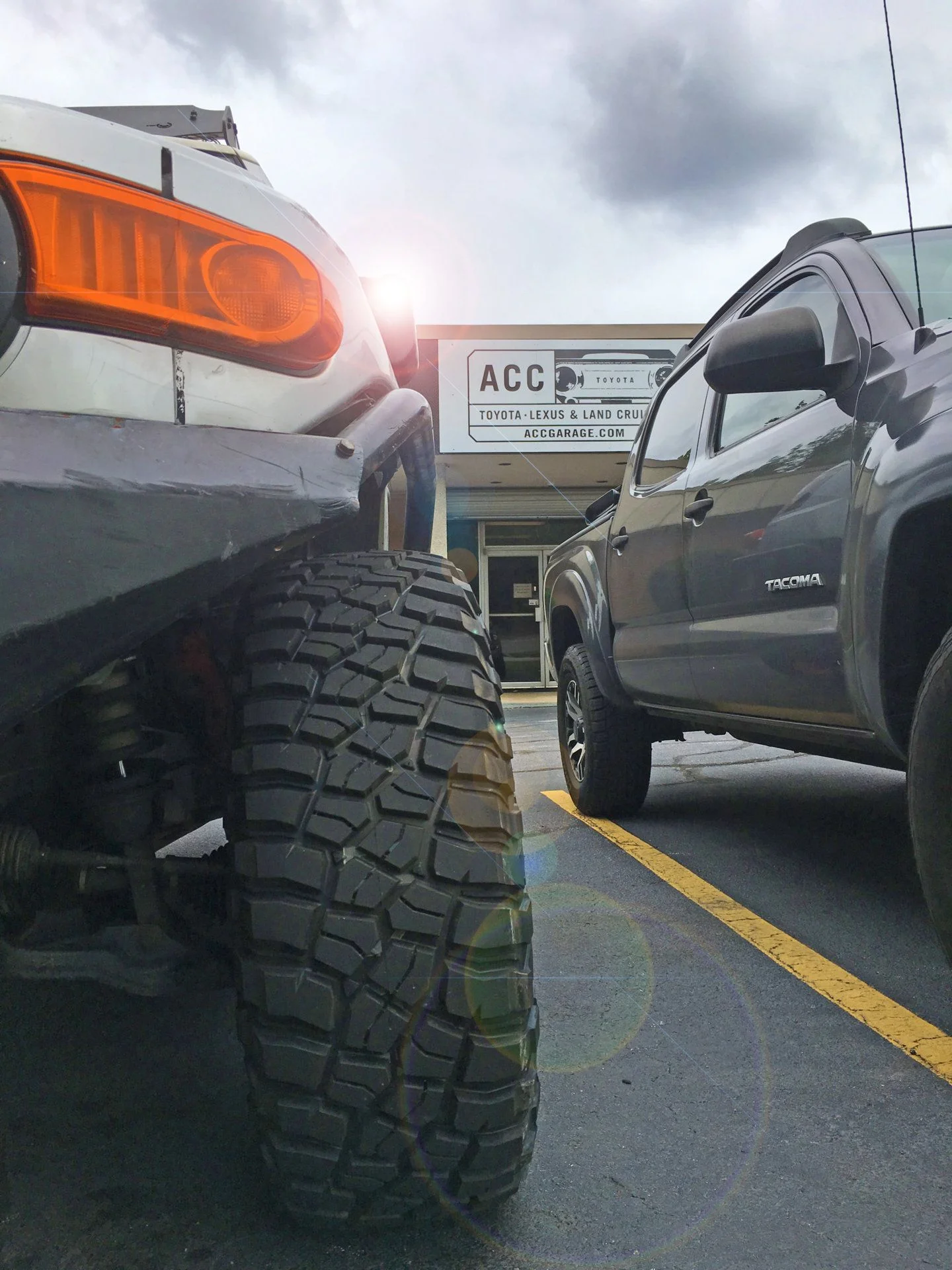

A decent tire. I've had mine on since Sept.

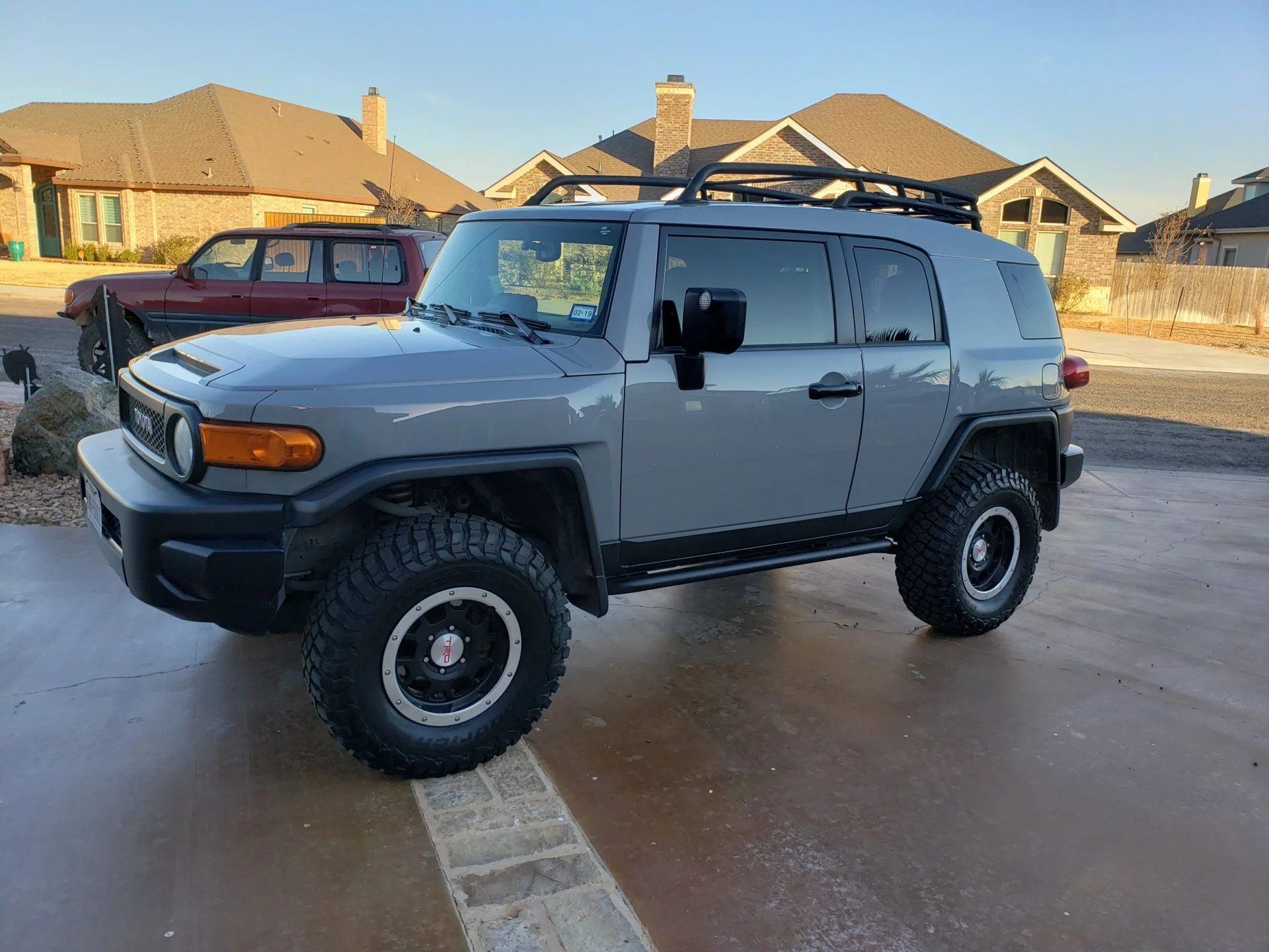

I think it is the right size .it still drives good. Looks meatier and didn't have to body chop. My biggest concern was drivability. My old fjc had 35s and struggled on the highway to find a gear.
