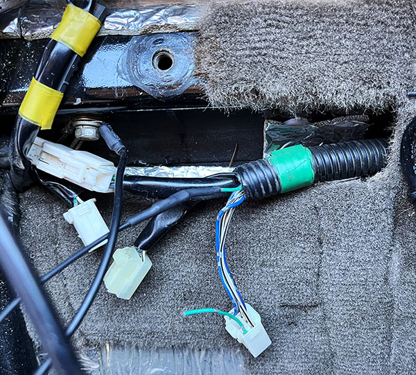

Hi all - this is my first post after lurking for quite some time. My son and I bought a '97 from the classified section here a few months ago and it's presently living with me in New Mexico. I've had probably a hundred questions about it, all of them answered by searching the rich history of this forum. I appreciate all the wisdom here and have benefited from many of the contributors.
Despite owning the wiring diagram manual I've been unable to identify these three mostly unused and disconnected circuits underneath the center console. (For reference, the bolt hole is the one under the cup holder and the passenger seat is to the right.) The circuit with the exposed wiring has a green wire cut and reused for some auxiliary lighting installed by the PO. While running a USB to the console I disconnected the aux switches and, despite having made notes, I'm having a hard time getting them back to working status. If anyone can identify that particular circuit and maybe link it to the correct wiring diagram that would be awesome.
Two of those are wiring for optional left and right seat heaters. I'm not 100% sure what the third one is for, but I have it too. Anecdotally, it might be for the overseas option of a refrigerated console. All three were disconnected on my 96, but I now use the seat heater wiring slightly modified to power my Audi seats heaters.
The 3rd one might be for a 6 cd changer that is standard in the xl450 center console or the subwoofer that they put in the xl450 in the center console .
