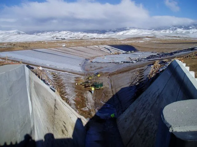

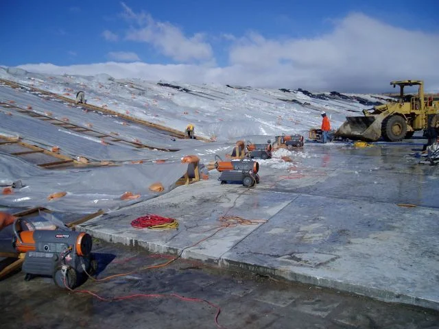

For your entertainment...
Third pic of bearing pads with insulated blankets with a string of incandescent light bulbs underneath. 55+ degrees maintained. ;)
How well does the string of lights under the blankets work? Hadn't heard of that, but I LOVE the idea. Any idea how frequently the lights were spaced to be that effective?

The lights bulbs definitely help, the ground anchors bearing pads were big thick blocks placed direcyly in the ground so it might have been fine without them. The lights were strings used in tunnels with 150 watt bulbs every 5 feet so so.
