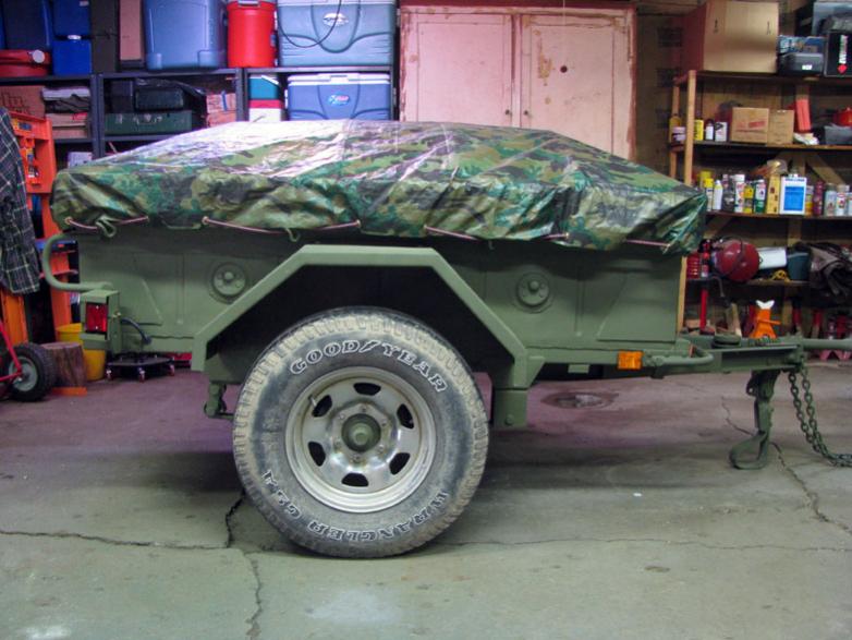

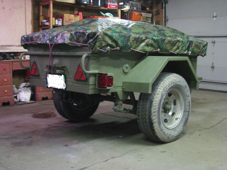

The diagram from the Yahoo groups site works well if you apply it to a ~5x8 tarp. I did the cheap ones to get the pattern right, then went with a nice heavy canvas one, adding custom grommets to pretty closely match the Yahoo group diagram.
Only a couple of lame pics, but the cat likes it. The bows will require a bigger tarp than you'd think and force you to make few adjustments with the grommet spacing. I'll see if I can find a pic with the good tarp on.
It also helps to add some reinforcing wear it'll rub at the trailer corners.
OK, three better tarp shots. Sorry, I didn't take any yet with the new green canvas tarp. You'll just have to imagine it's that one instead of the hillbilly:hillbilly:special.
Better tires under those nice fenders now...
The top pick is with the bungee taut, The other two when I was cutting the cord to length. I made it a little long.
The key to a good tarp is the bungee threaded correctly. This really works well, much better than rope, in keeping most dust out of the bed. I bought some bungee cord on a roll and some plastic hooks to terminate. Cut the bungee long enough to go around and thread through. It's a snap to use.
