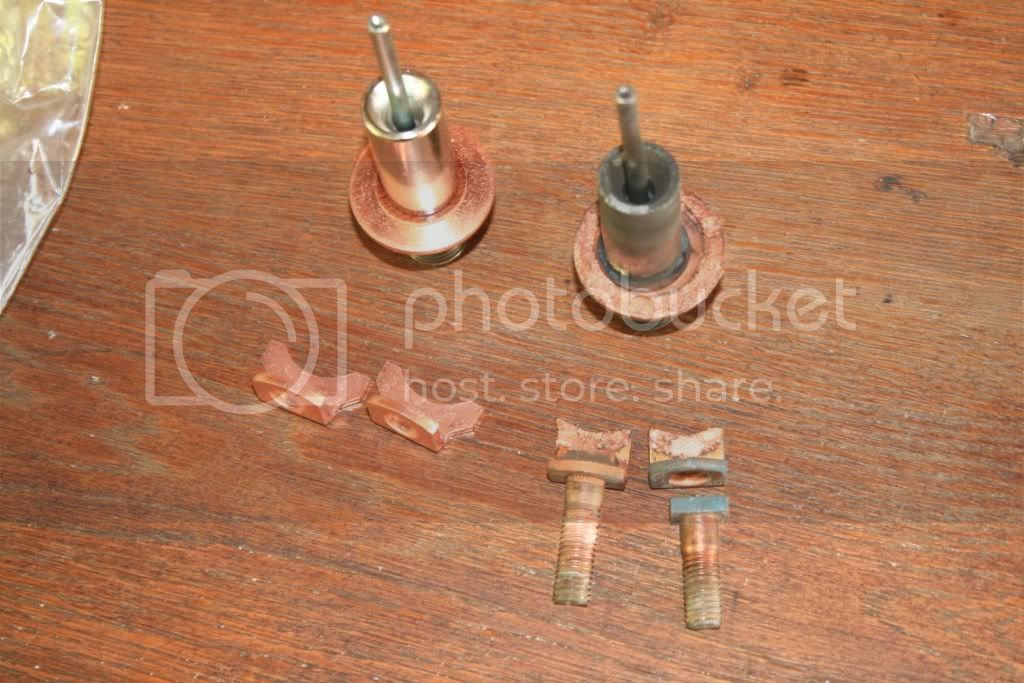

I ordered the Denso part, as the photos I found online seem to be appropriate. Will let you know, arrives next Friday.
For posterity, I ordered:
1 - Denso HEAVY DUTY COMPONENTS
Stock Number: 053660-0660
Part Number: 053660-0660
Unit Price: $7.59
Extended Price: $7.59
From densoproducts.com and its a perfect fit. Back on the road!!
Pic:

I sourced one from my local sparky, it was only €14.50, so that's cheap. I looked up the Toy p/n on ToyoDIY and it gave the price as being €180 or something.

Mine failed "open", so the starter just wouldn't turn on at all. There were actually pea-sized balls of molten copper inside the solenoid from what was left of the disk.
