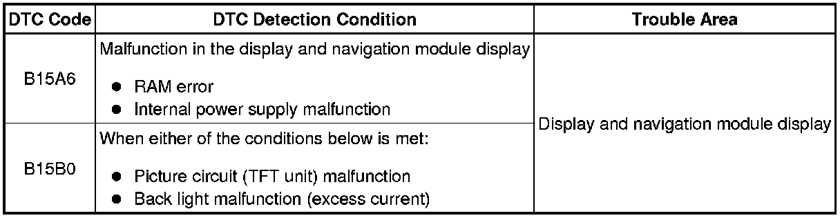

NAVIGATION: NAVIGATION SYSTEM (for DVD): B15A6,B15B0: Display Malfunction
B15A6 - Display Malfunction
B15B0 - Display Screen Malfunction
DESCRIPTION
These DTCs are stored when a malfunction occurs in the display and navigation module display.
10814310
INSPECTION PROCEDURE
PROCEDURE
1. CHECK FOR DTC
(a) Clear the DTCs Navigation System (for DVD).
(b) Check for DTCs and check if same trouble occurs again.
OK:
No DTCs are output.
NG -- REPLACE DISPLAY AND NAVIGATION MODULE DISPLAY
Removal
OK -- USE SIMULATION METHOD TO CHECK Electronic Circuit Inspection Procedure
