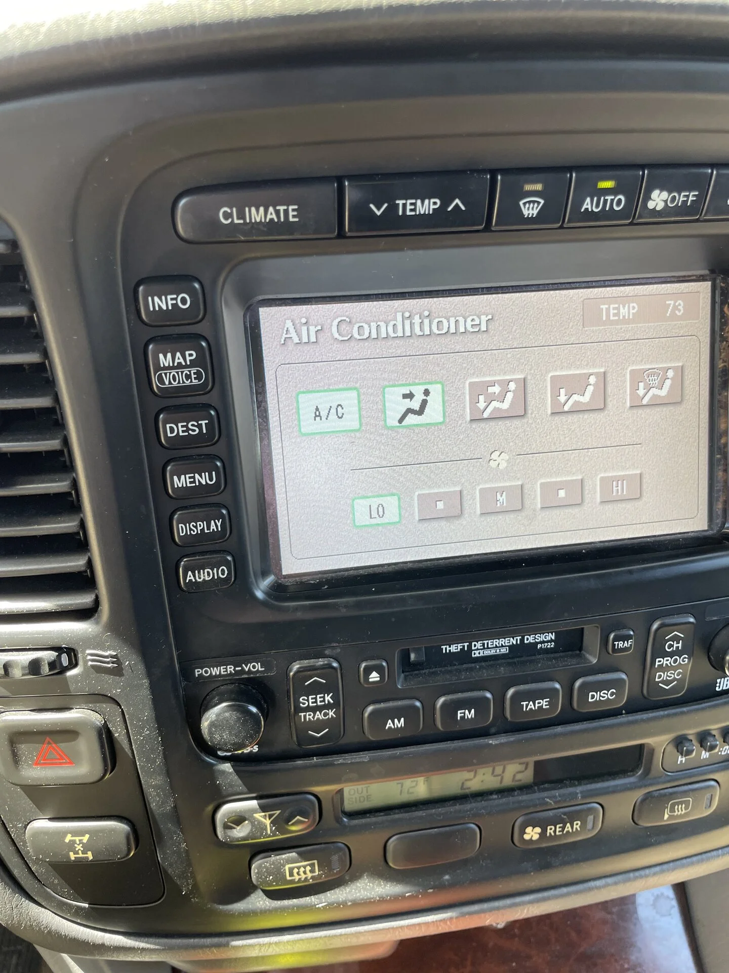

new to me 2002 lc with factory NAV but screen is inoperable. I've seen just screen replacements on eBay for like 280$. Has anyone used these? I'm not really looking to upgrade and don't care about NAV but would like to see A/C -Heat functions etc..Any thoughts on a reasonable priced replacement ?

Thanks. NAV screen finally came in and installed. I get better color but still no function from screen? A/C and radio work but again just a blue screen? Any thoughts on what else might be causing no function. Old screen was toast.(see pic). I’m now thinking in may just delete NAV entirely.
Ok, so you're getting just a blank screen no matter what function you're on?
Thanks jsloden on recommendation. Took a little longer to receive screen but paid around $90 with shipping-deal! A couple of things I did / observed. There were 4 tabs/ screw holes on back of new screen I snipped off. Also there is a 3 wire plug going to circuit board I tried to pull off and broke. Re soldered. Probably should have left alone. I think only 4 ? Things need to be unplugged once entire unit out of vehicle.

Good question. Possibly? Mine was totally out. Talking to others with glitchy systems it’s 50-50 shot.
It seems like it would work. You just have to VERY careful with the ribbon cables. If you have ever replace the lcd in a laptop or some other device you shouldn't have a problem. Just take your time.
