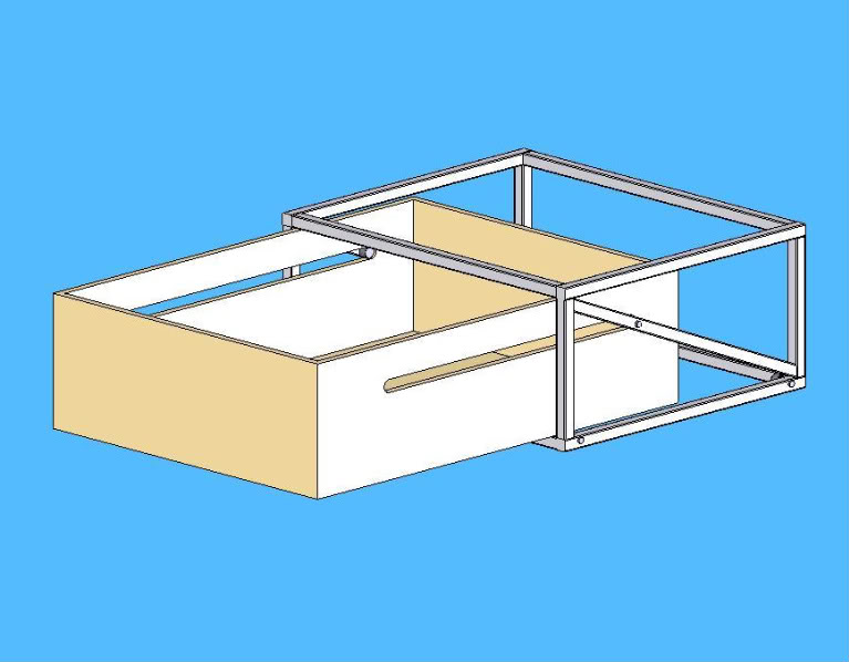

Many years ago I posted this jpg of a model I drew on Expo. It lays out how I would build drawers on rollers rather than using slides. There are rollers under the bottom edge at the rear of the frame structure.
If the shell can support the total tent loading I see no reason why the box couldn't as well. Structures like this don't like point loads, they prefer distributed loads and the shell would provide that with the full length contact at the top of the box.
I would consider covering the whole structure with a couple layers of fiberglass woven cloth and resin.
I thought I would make it as simple as possible and just use Teflon (or similar) strips along the bottom of the slideout box, and the runners on the floor of the main box. I'll use simple stops to keep it from coming all the way out, and adjustable drop-down legs to support it at the end once it's pulled all the way out.
