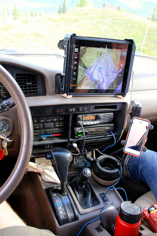

I too keep my iPad mounted to the windshield and have all rows in use with 4 kids. My wife never complains about the lost middle vent and the kids seem to stay cool on hot day, but I will be honest, if we are in 4-low we have all the windows open and the AC off.
An added bonus of this mounting location is that the vent keeps the iPad cool, which heat is a real issue if its in direct sun.
Toys
by Matt Ewalt, on Flickr
Previously I had it mounted where my iPhone is in the above image, but my wife was not a fan of having it "in her lap"
1996 Toyota Land Cruiser interior by Matt Ewalt, on Flickr
