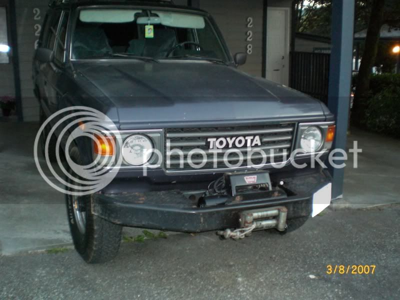

my new to me Warn xd9000i

thanks to some of you guys here i decided not to buy a cheapo winch , and picked up a used warn , looked at alot of 8274's but most were trashed and the owners wanted too much , i like the way this winch sits down in the tray , full air flow to my rad .winch seams to work , powered it in and out and free spool works great , if i never have to use it i will be happy , just some peace of mind when i have my family with me , just need to pick up a little bit of rigging .

It's the same winch I have on my 60. Except mine is in my ARB and I had to mount it feet forward, so the winch is lying on it's back.
Someone painted yours black?

i had to open up the solenoid cover and clean the contacts , warn lists this as not needing to be greased for servicing , the previous owner said he used it four or five times there was dust webs in the solenoid case it looks quite nice and shiny inside apart from the the dust and oxidation of no use it was spray bombed just where it had oxidized , i was thinking about spaying dieltic or contact cleaner inside but have yet to , i sprayed the roller fairlead with a lanolin based anti corosion inhibitor and the cable with some graphite and molly wire rope spray used for forklifts .

Warn says that, but lots of guys on here have pulled them apart and seen water and rust. So it would not hurt to pull the cover on the gear end..........in the future.
