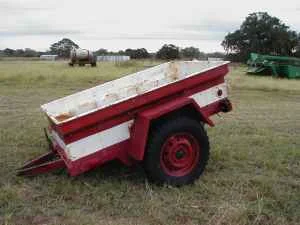

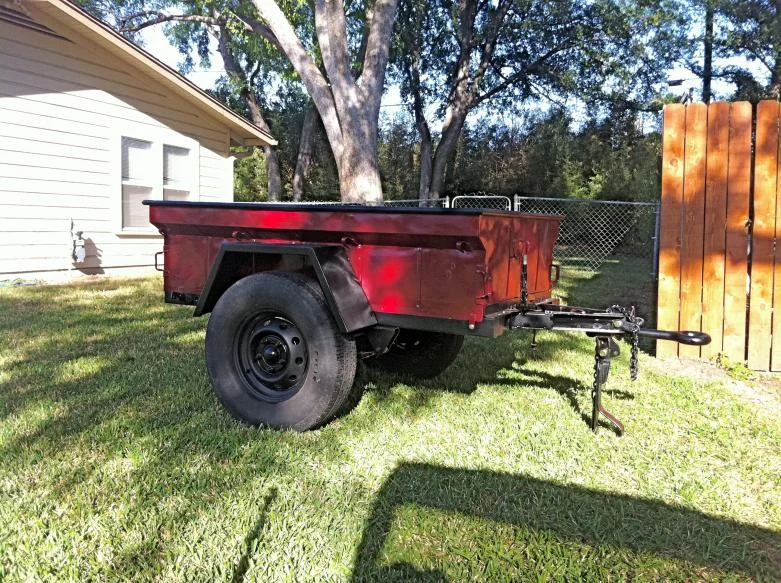

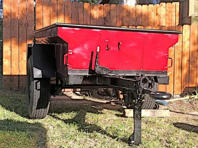

Here's a before and after shot.
Well here she is. My 1964 M416 is a former Travis County Fire Department trailer. I think that it spent most of its life parked behind a fire station and that it saw very little use.
The trailer is missing its lunette casting, lunette ring and landing leg. The tires are both unserviceable due to dry rot. There is very little rust and overall I'd say that the trailer is in very good condition.

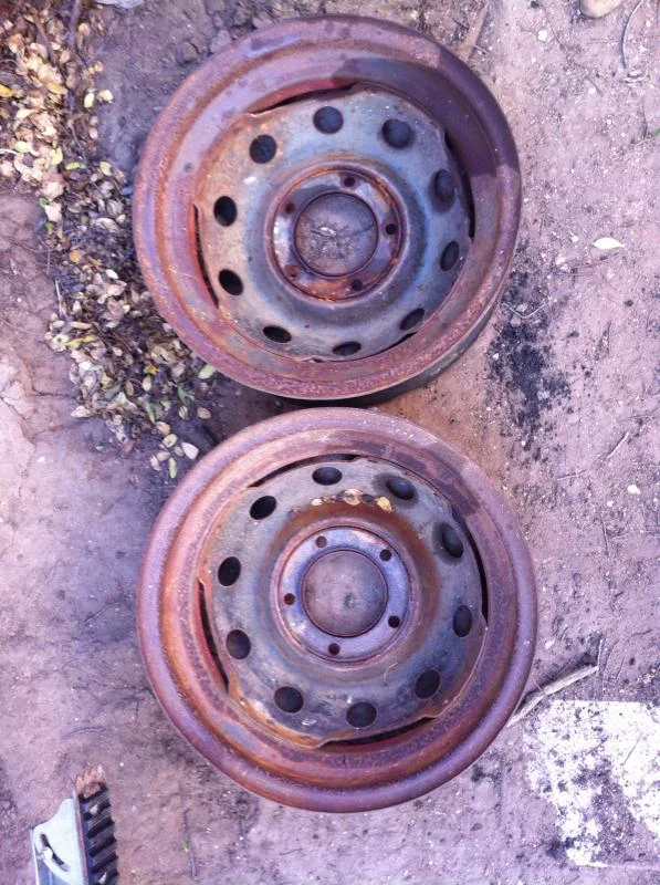

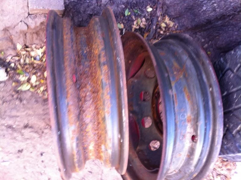

Well here's the first thing that I need to get done. The tires were totally hammered, so I trashed them. Once I got them off, I noticed that one of the rims had quite a bit of rust inside. I'll be breaking out the wire wheel and sandpaper later on today. Once I get the rust off, I'll rattle can them with flat black rustoleum.
I'll mount new or newish 235/85r16 tires on the rims. I am on a budget, so the final tire choice will go to the cheapest option. I am leaning towards a pair of craigslist BFGs right now.

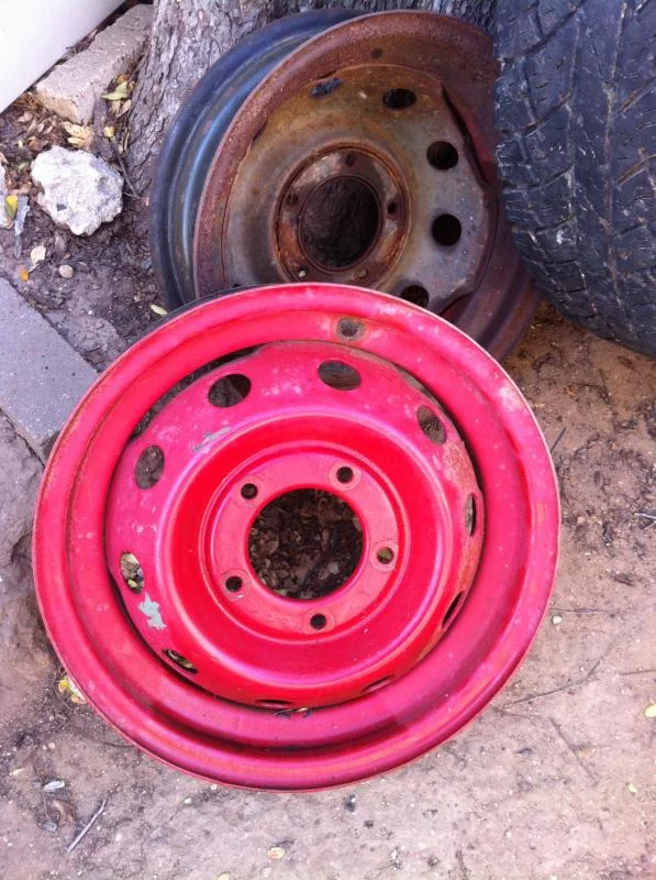

Here are some before pics of the rims ...

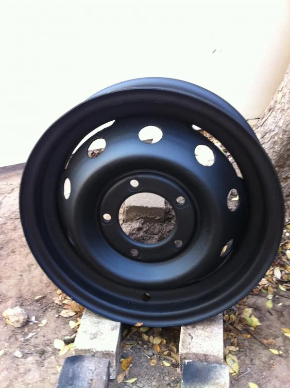

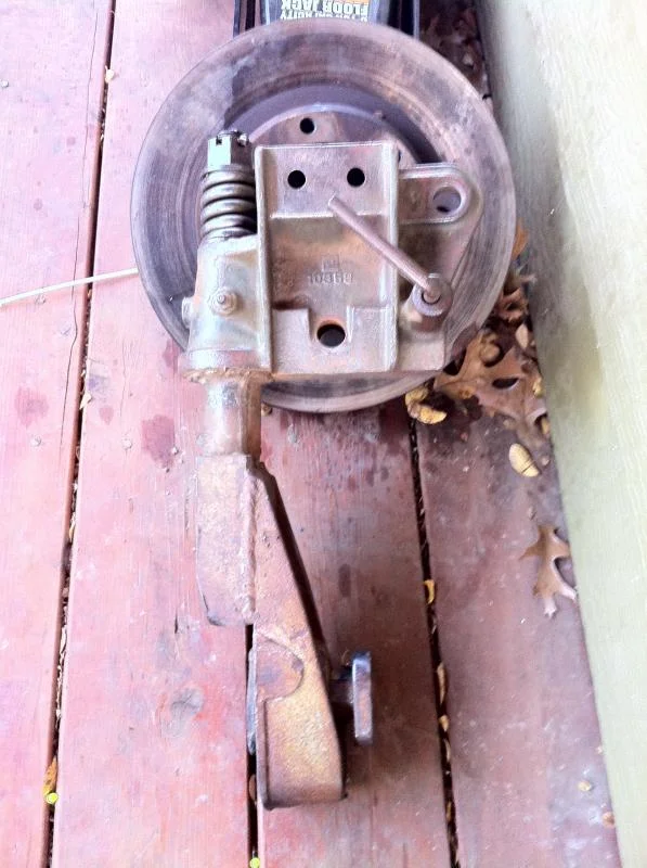

The wheels are done. They've been wire wheeled, sanded and painted with three coats of flat black rustoleum. The lunette casting also arrived and and i cleaned it up as well.
Once I find some good, cheap tires I'll be able to bring the trailer home for the build.

Well, the tire shop sold the last two cosmetic blems before I got there. I ended up putting on two used, though healthy looking, 235/85r16 trailer tires. They are both 10 ply and should do well.

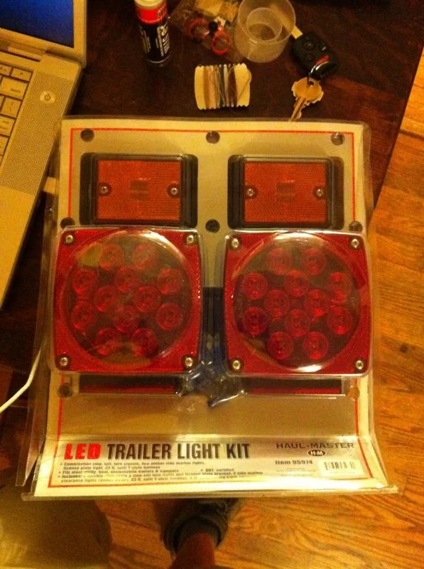

I am still working on the coupler a bit and I am assembling the wiring harness for the lights. This way I won't be spending too much time in the farmer's field before being able to haul off the trailer.
I got an LED trailer light kit on sale from Harbor Freight for $29 - a good deal in my book.
Here are some iPhone pics of the tires and light kit:

I used the same H/F light kit for my trailer and the stop lights are really bright and the overall quality seems good.
