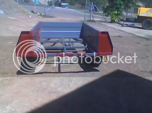

hey guys, thought i'd post up some pics of my new box trailer. after not being able to find a trailer with any sort of quality at a half reasonable cost, i decided to build my own. I have access to a full fab shop at work so i had no problems with gear or advice. spec are as follows- 6x4 trailer with 420mm hugh sides
t/gate, front panel & floor-2mm zinc
side panels-1.6mm zinc
drawbar-75x50x3
frame-50x50x4
uprights- 40x40x2
tie bars- 15mm nb pipe
approx cost total cost when finished is $700aud. all that's left to do is wire it up then strip it & paint it. Cheers, mike.
albums/zz92/pageys/trailer%20build/DSCF2904.jpg[/IMG]

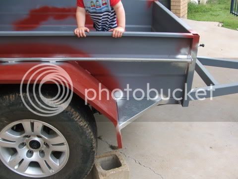

some more pics
I like it
Looks like it is "Son of Stinky" approved as well.
The towels bars are for tie downs BIO..it's a very popular mod down unda'
the "towel racks" are for strapping loads down with either rope or ratchet strap. couple more pics of the build. Son of Stinky, more commonly known as Ziggy, loves anything to do with 4x4s, camping, fishing & the boat. He's my little helper.
