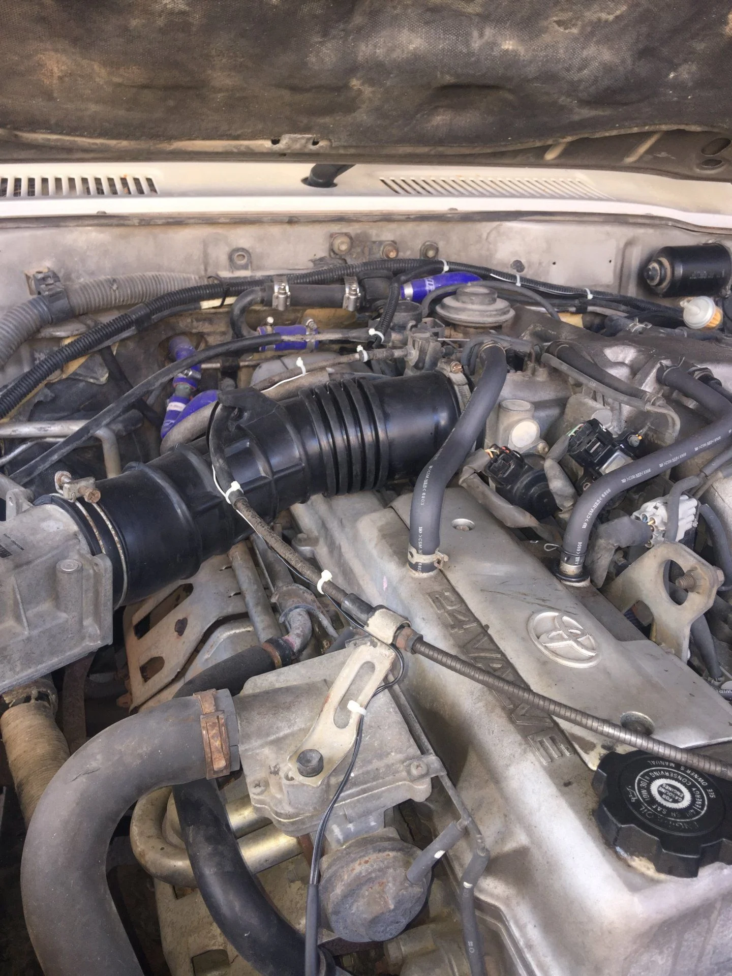

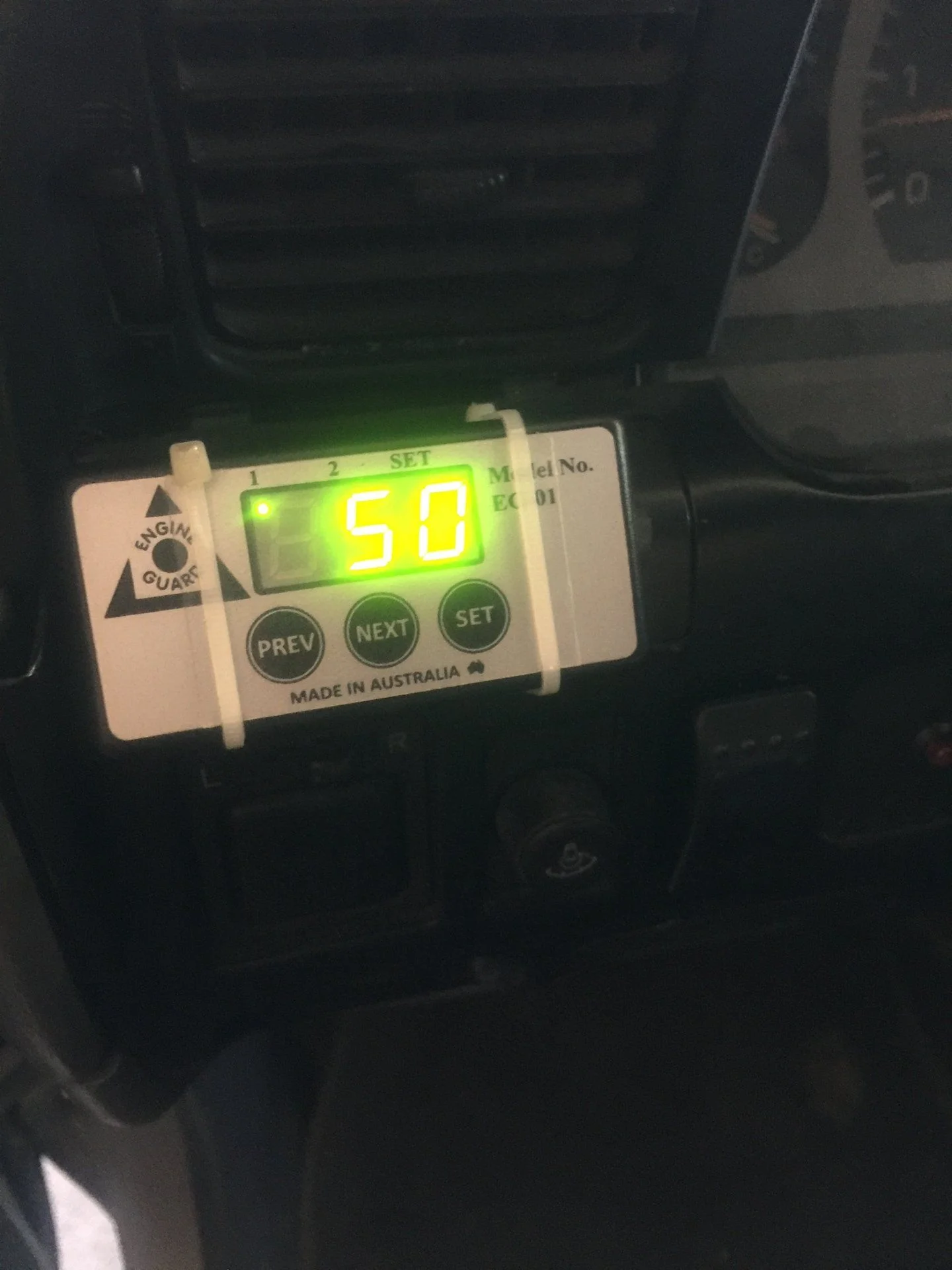

I just installed auxiliary engine temperature dry meter alarm (Australian 2 sensor unite plus buzzer)
The rational is to get an indication of fast losing all coolant at once in short time before any damage :deadhorse:
The installation of the dashboard and on the engine is temporary locations

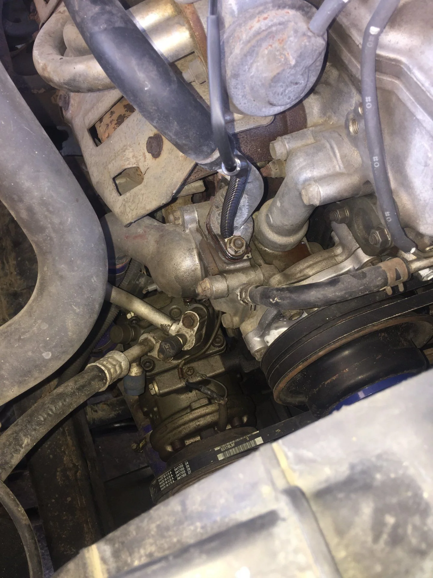

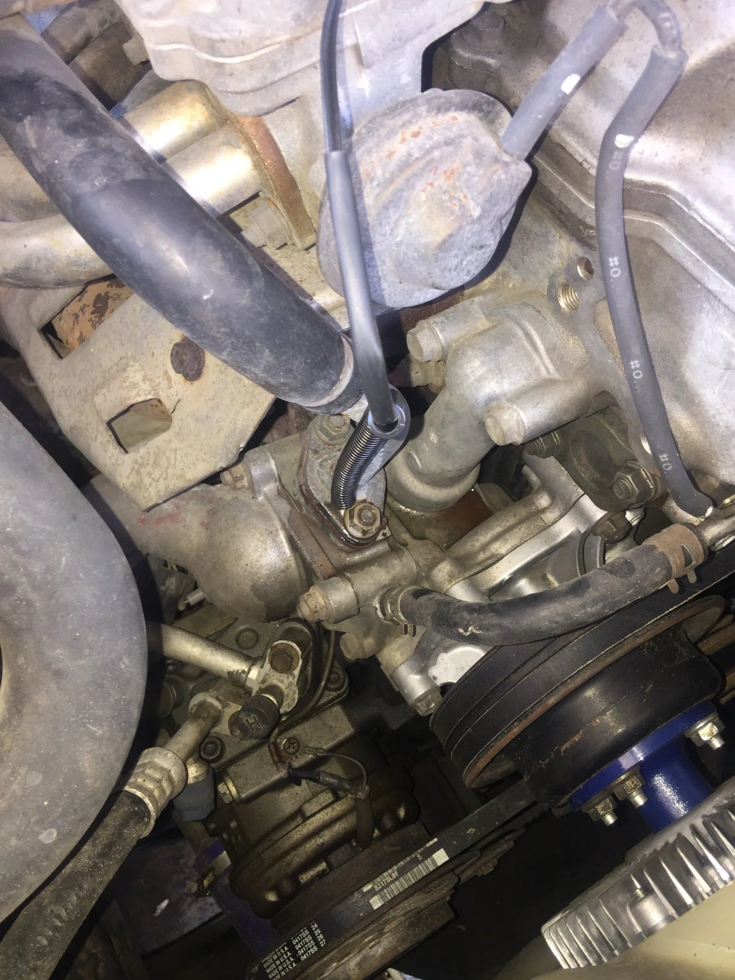

On the engine is now on the thermostat housing I get in the hot day of 93F I measure 168F on highway and 185F in slow traffic or up a mountain with AC
I will move it down the block later - suggestions of a a bolt in optimal place are welcomed
On dashboard I do not want to drill and I will leave it there, although it is ugly with the 2 zip tie :bang:

I've always had mine bolted to the head to read the metal temps.

this one can have 2 temp sensors with programmable audio alarm
By normal I mean an actual temp gauge in the coolant passage. The alarm part would definitely be nice
