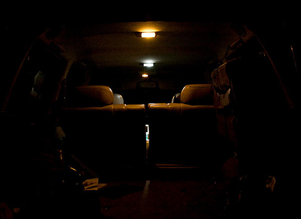

Here It was before, The middle one is LED . But the rear really shows how much the light is not doing its job!

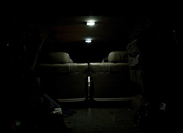

Here is with the rear one in. Pics dont do it justice but it is an amazing difference!

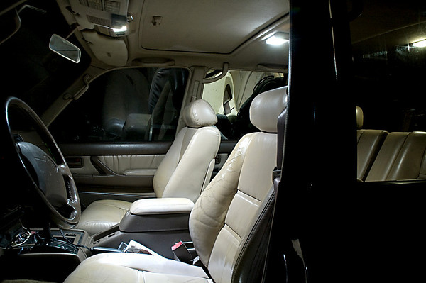

So I am happy with them! I also ended up doing the doors.
heres a couple pictures. Before and after with Georges L.E.D. domes. Love the bright white light.
Wow that did make a big difference! looks good!

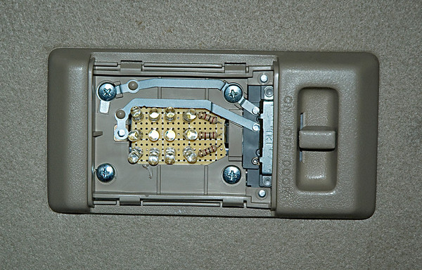

What I did was get some PC board all the LED's and resistors needed, then it was a matter of sodering everything together. Then put together my connectors. The door tights were the easiest, but by then I had all the stuff figured out. From what I hear Georges are awesome! I dont know how many LED's per light he used, on mine I only have 12 per light, but they are 7,000 Mcd (which is their intencity). I left room to add more, in case 12 were not enough, but am happy with them and won't add any more for now.

Here is a picture of my LED board. Installed in the rear dome light. I decided to mount it from the top. In it you can see the resistors and the LED configuration.
These LED's are 30 Degree, so I angled the outside ones to broadcast the light better. ( Im sure georges look alot better!)
Since im not the photographer of the family, I had my :princess: take better shots of the lights after they were all installed. (map, 2 dome, and 4 doors). So how does it look?
