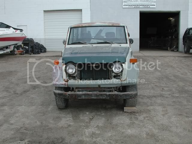

in case you missed it here is the front:

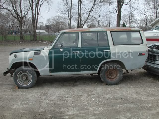

and driver side:

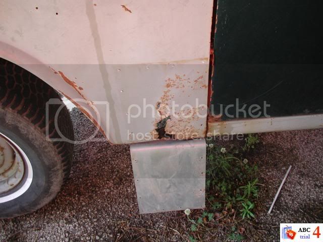

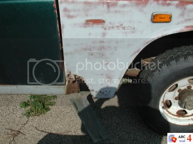

today i started out with a full can of PBBlaster and ended up with an empty one... got the tailgate open (was an achievement), took off the front fender vents, and tried to get the lights out. removed 2 riveted patch panels on front fenders and wanted to cry lol:
from the looks of things the passenger side fender assembly is heading to the trash can (dont think it will hold up long enough to go to the scrap yard lol) but not sure yet,

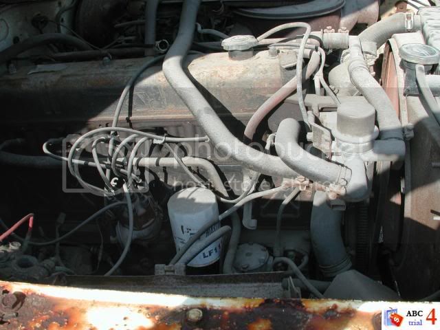

and i had a question about the motor:
is this an f.5?

Mike,
Great that you have it home........can we see a pic of the engine? Is the oil filter on the right side under the manifold or is it on the left near the dizzy?
Looks like it's fairly complete. I'm diggin the mismatched turn signals :lol: I wouldn't throw any body parts away yet. Take this time to learn to patch & weld in new metal. A can of mapp gas goes along great w/ penetrant heating up rusty old bolts. Are you set up w/ the tools it's gonna take to bring this :pig: back to it's once grandness? A small mig welder w/ a C-25 mix should get you started on sheetmetal work. You'll also want at least a 60 gal. air compressor, minimum. Is this :pig: your 1st project? We're all here to help out so post up any questions along the way :cheers:

its a 74 body on a 73 frame (transfer done by po).
current plans are a resto mod, brakes need work, engine starts, exhaust is in back of truck.

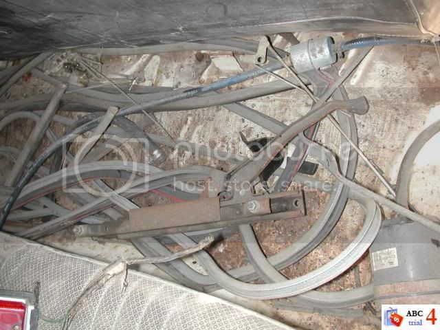

3. original toyota jack, handles and such under back seat:

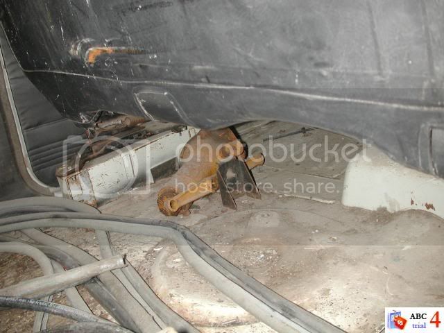

4. whats this panel go to?

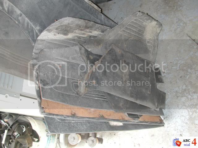

5. pass side floorboards (had a sheet of 1/8" aluminum screwed over it:

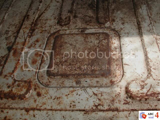

6. backseat floorboards:

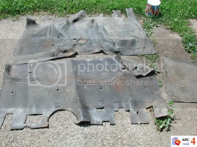

7. original floormats?
