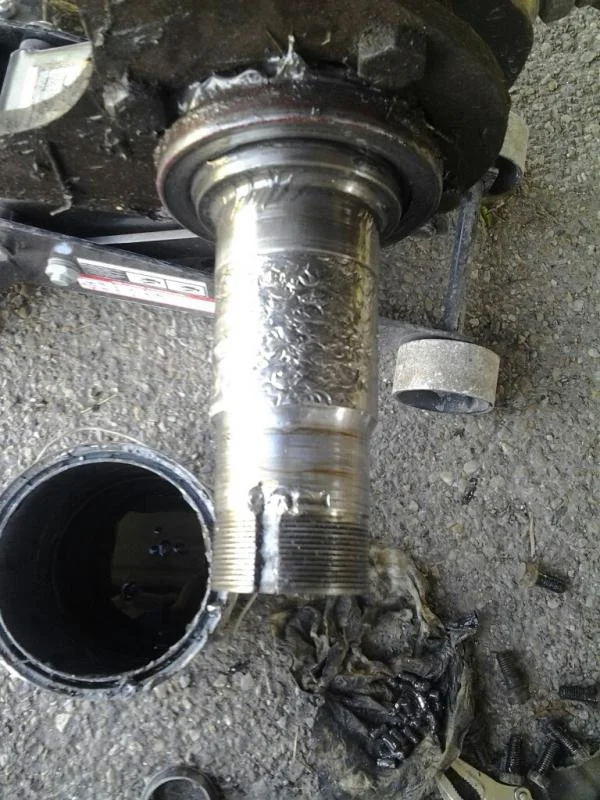

I am trying to get my 40 for the Round up and doing some maintenance and here's what I found.

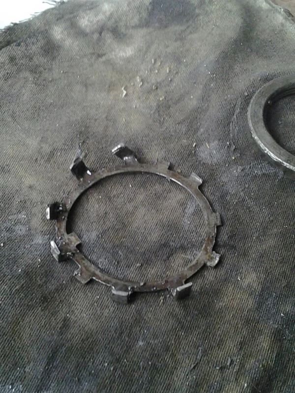

Grease was coming out from the back end of the rear seal and once I took it apart I found this for the second time, since this had happened before.
Oh I forgot to mentioned, this spindle is from a 14bolt. The lock nuts still good and go through the full thread and it's thight but the outer bearing is toasted. I found just the ring and was able to come out ez. it wasnt welded on the spindle. there was only one lock thingy that was broken and was missing a locking thingys that helps to have the lock nut in place.
any guess of why is doing this?:hillbilly:
here are the locks and the broken thingy missing teeth. I am saying this thingy missing teeth, like Kowboy once, is the one causing the hub to become lose.
A buddy of mine says that the spindle is bent and I refuse to believe that. it's a lot of work into it,

I have another 14 bolt on stand by but I sincerly dont want to go through the whole thing of cutting brackets and welding'em again on a new housing.
dana 80 would be nice, but as you know, budget for the toys is always tight.
