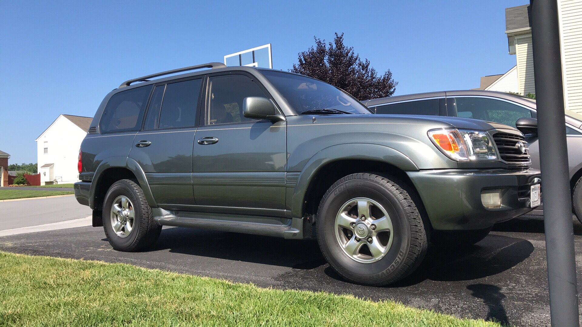

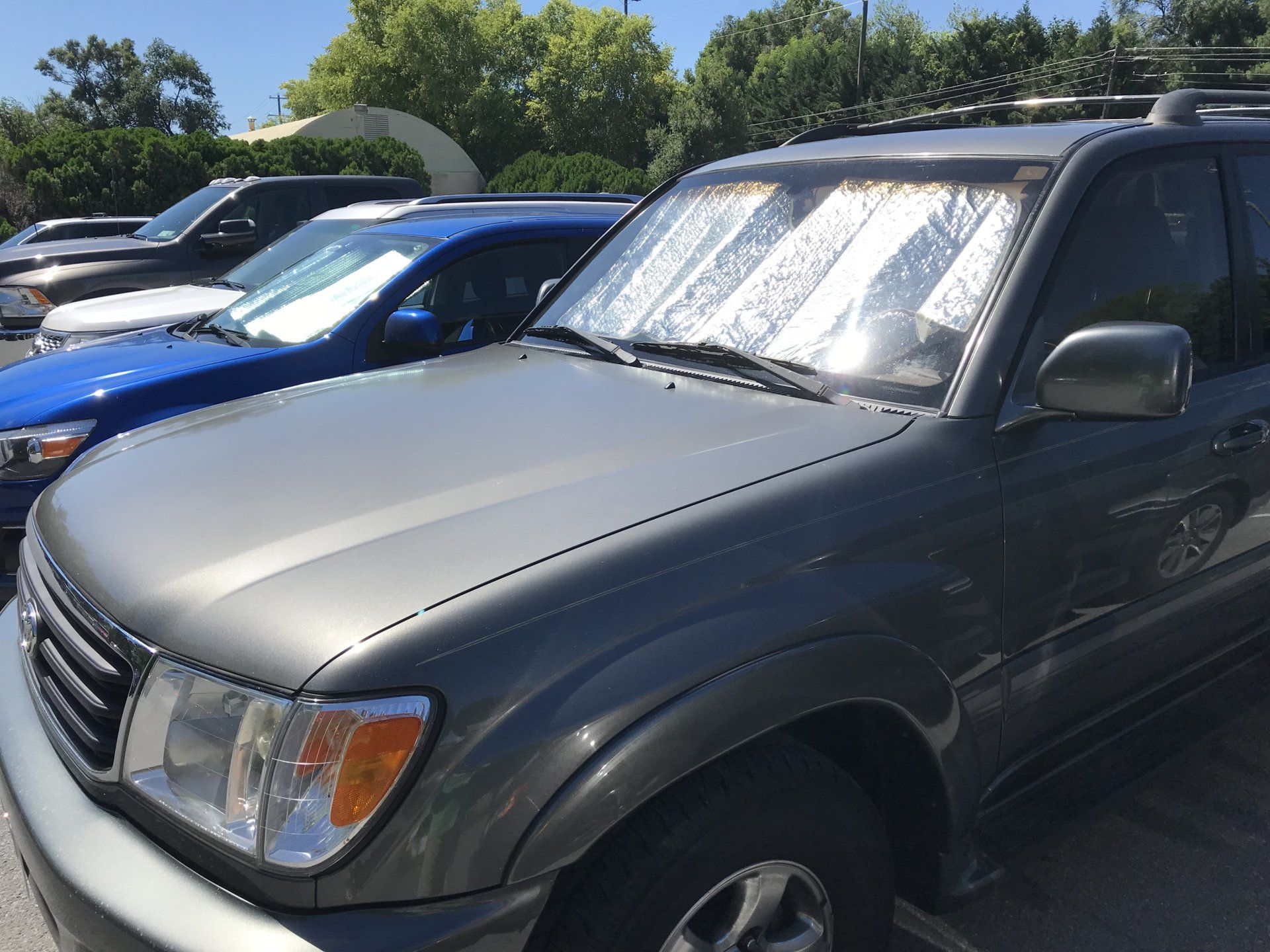

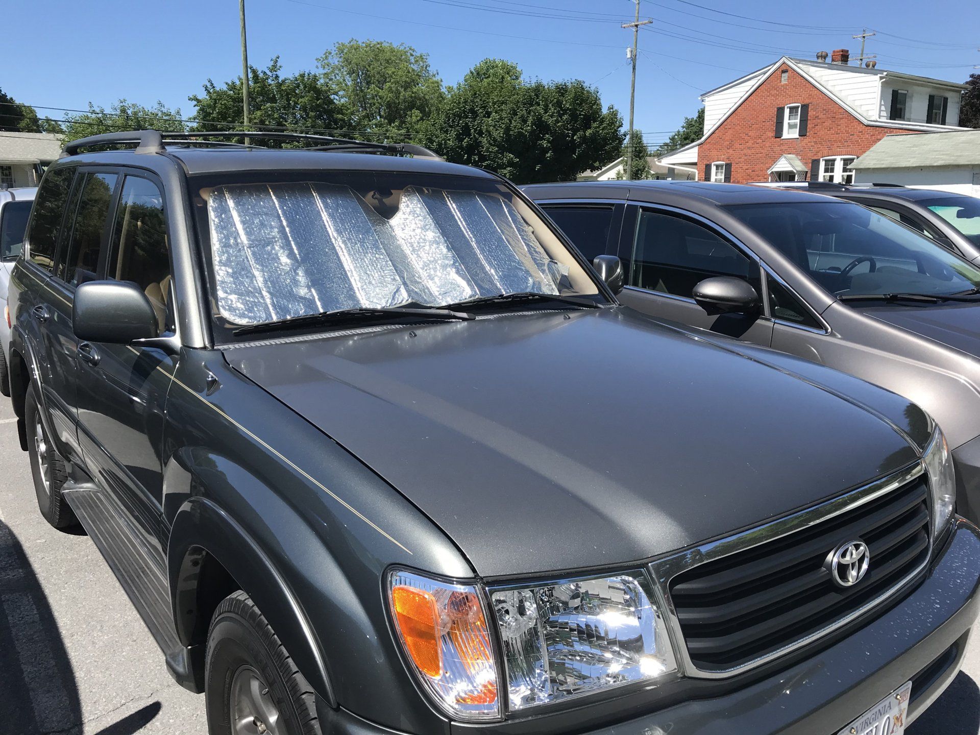

Hey fellas, I’m still pretty excited at my new purchase but I’m starting to see all the PM that didn’t get done on my 2001. She’s got 210k on the clock and pretty well cared for...however...I’m pretty sure the timing belt is due (no previous record of it) and the PO pretty much just changed oil and tires and took care of an O2 sensor issue at 155k. What I’m most concerned about is after washing the truck really well I can see the hood is a different color in the sunlight. I didn’t notice it at the time of purchase so I didn’t ask the PO about it. Finally, here’s my “ask”. Could someone run the VIN and see what the recorded history is on my 100? JTEHT05J012007186
I know Carfax or other agencies don’t catch everything but I’m hoping for a clean report anyway. I’m in NW Virginia and have Ryan at OTRAMM checking it out at his next available appointment (4 weeks). Thanks for any assist you guys can offer and I’m happy to be a part of such a “prestigious” group!

That is definitely a different hood than it was born with or it has been repainted. It would not fade that evenly.
Open the hood, look on the passenger side down near the hinge for a VIN tag. It should match your vehicle VIN number if it the original hood.
