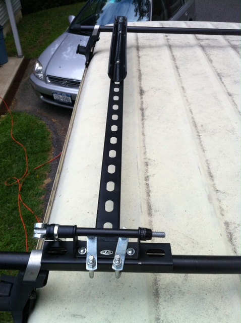

Here you can see one of the racks, fully installed and mounted on the roof of my FJ60:

Thanks, man. It was a simple enough job that I figured I'd share it and hopefully give someone else some inspiration to build exactly what they need, instead of buying something that kinda sorta fits the bill.
Yeah! I was an electrician for 15 years so i always had that sort of stuff laying around. Thanks for sharing I am sure someone can use the info.
