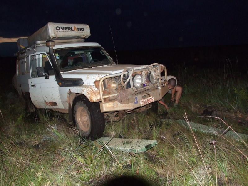

Good job! That material looks similar to what RADIOBOABAB used in Congo. See post 13. Democratic Republic of Congo: Lubumbashi to Kinshasa - Page 2 - Expedition Portal Forum.
It does look a little thinner though.

Theirs do look like a composite material waffleboard
