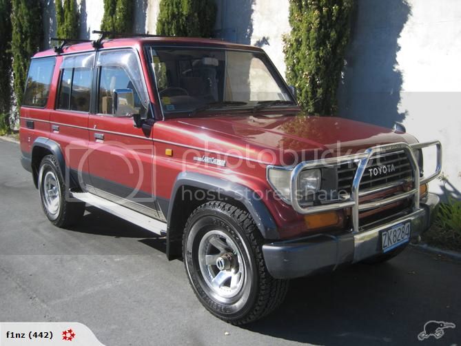

I started with this extremely tidy 1993 70 series prado from a car dealer for a very good price
Honestly they almost give these away over here compared to some other over priced 4wds

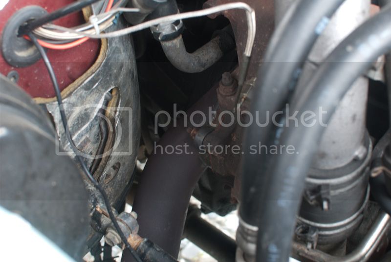

He also intstalled a 2 1/2" full mandrel exhaust from the turbo back, including a very tidy dump pipe.

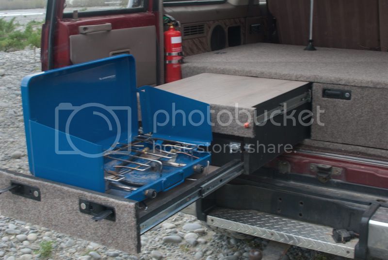

I do a lot of camping and fishing so was looking wanting to make a portable kitchen for our impromptu river side bbqs.
So I decided I definitely needed a prep board for the food
and then I needed somewhere to do the cooking
and heres one just so you can see how it all looks closed up
