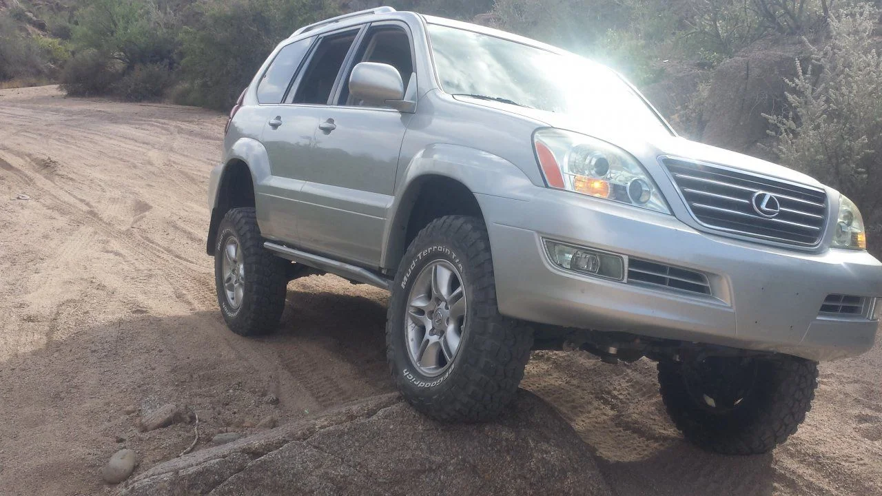

H11 Headlight bulbs 3600 Lumen, Bare sliders waiting to be Rhino Lined in Matching Paint color
There's no way those pnp bulbs are putting out 3600lm of useable light. OEM vehicles that use LEDs for their headlights don't even use one lens IE: H11 projector...they use multiple lens that focus the light properly and have multiple cooling fans / heatsinks and it takes up the larger portion of the underneath and or backside of the headlight housings.
Don't believe the hype w/ those LED pnp bulbs.....
They have cooling fans on the back of them. I had to take the battery out to install them on the drivers side of the car. I also had to raise the headlight angle so that are actually shining upwards. They had a tenancy to only shine directly in front of the vehicle. As far as 3600lm.....That is what is claimed. They are bright enough. Are they as bright as HID....well....no....nearly, but not quite.
Those H11 LED's are not meant to be used for headlight low beams. Aftermarket H11 LED's are illegal because the light output does not meet DOT specifications. H11 LED's are O.K. for running lights, but that's about all. I don't care how many lumens those LED's produce, the pattern is all wrong for any OEM headlight assembly. Someday, ALL vehicles will have LED headlights, but the LED stuff being sold for aftermarket use right now is just Krapp. (That's my personal opinion.)
