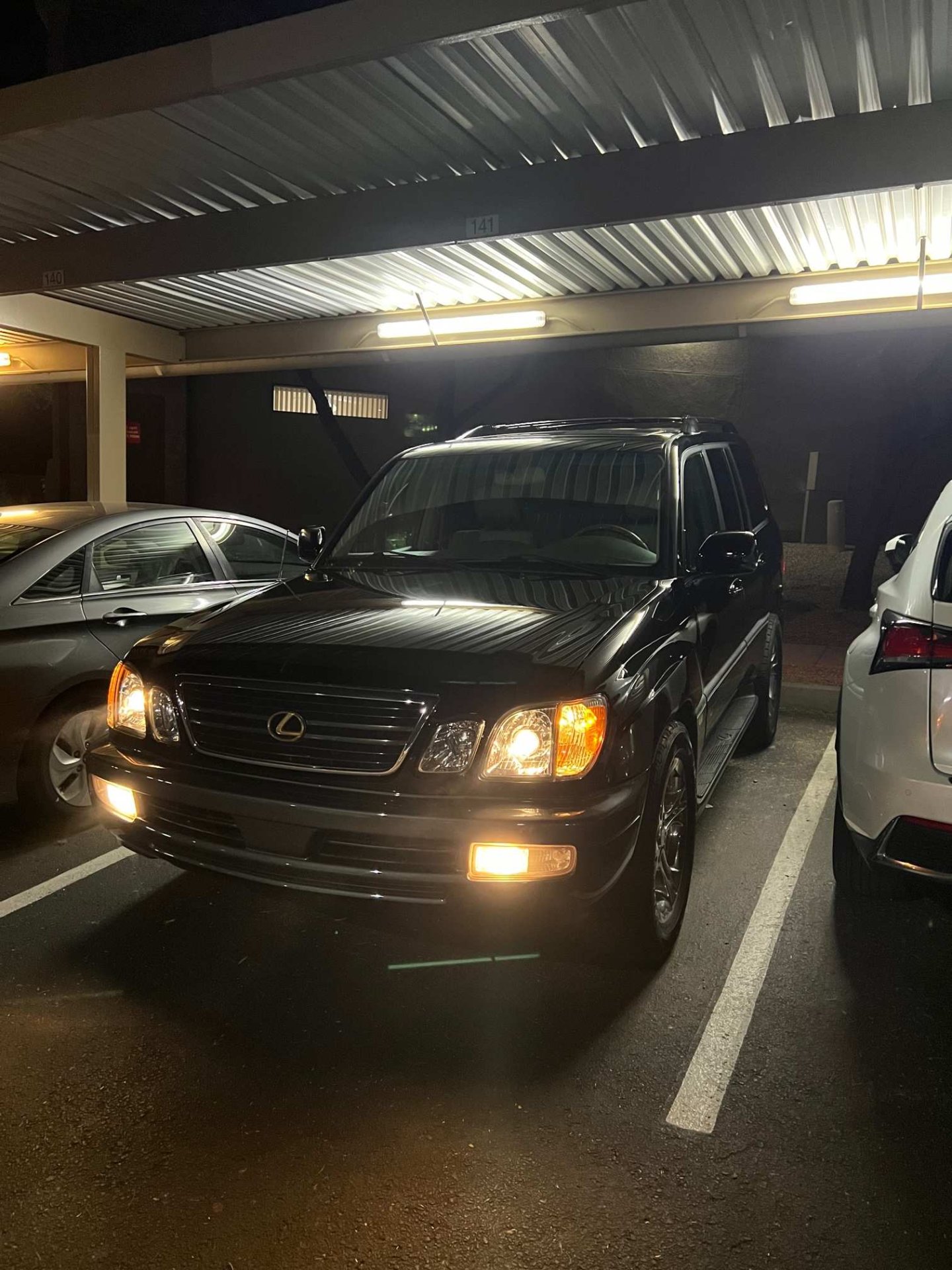

Hello everyone, just picked up a 2004 Lexus LX470 with 106,099 miles on it. Essentially 1 owner, original owner passed and their next of kin sold it to me immediately.

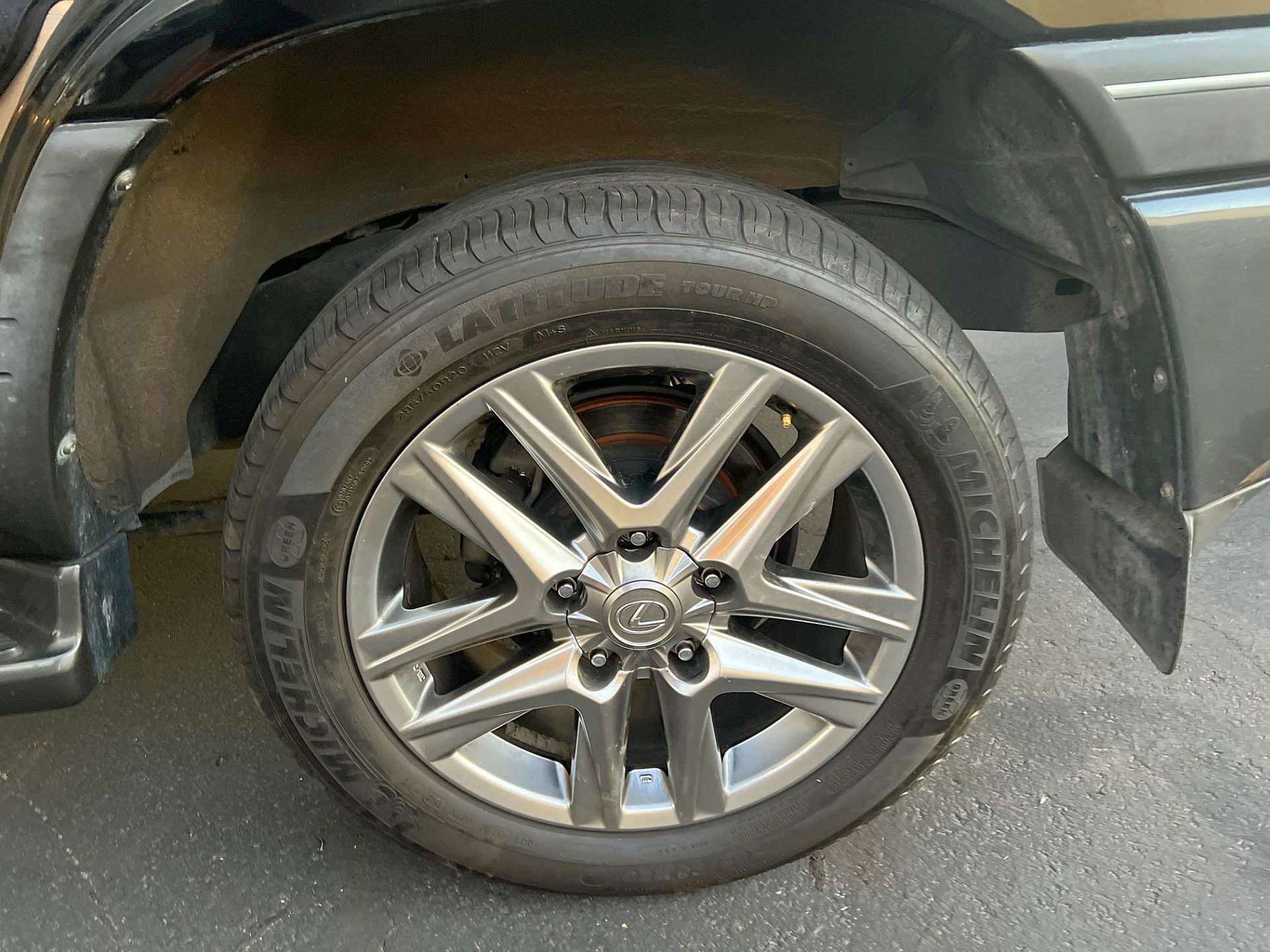

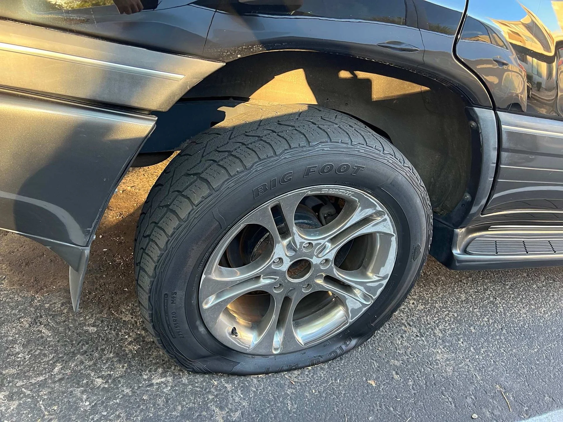

First step was to address the wheels as within a week I had a flat tire. Not the greatest experience right off the bat.

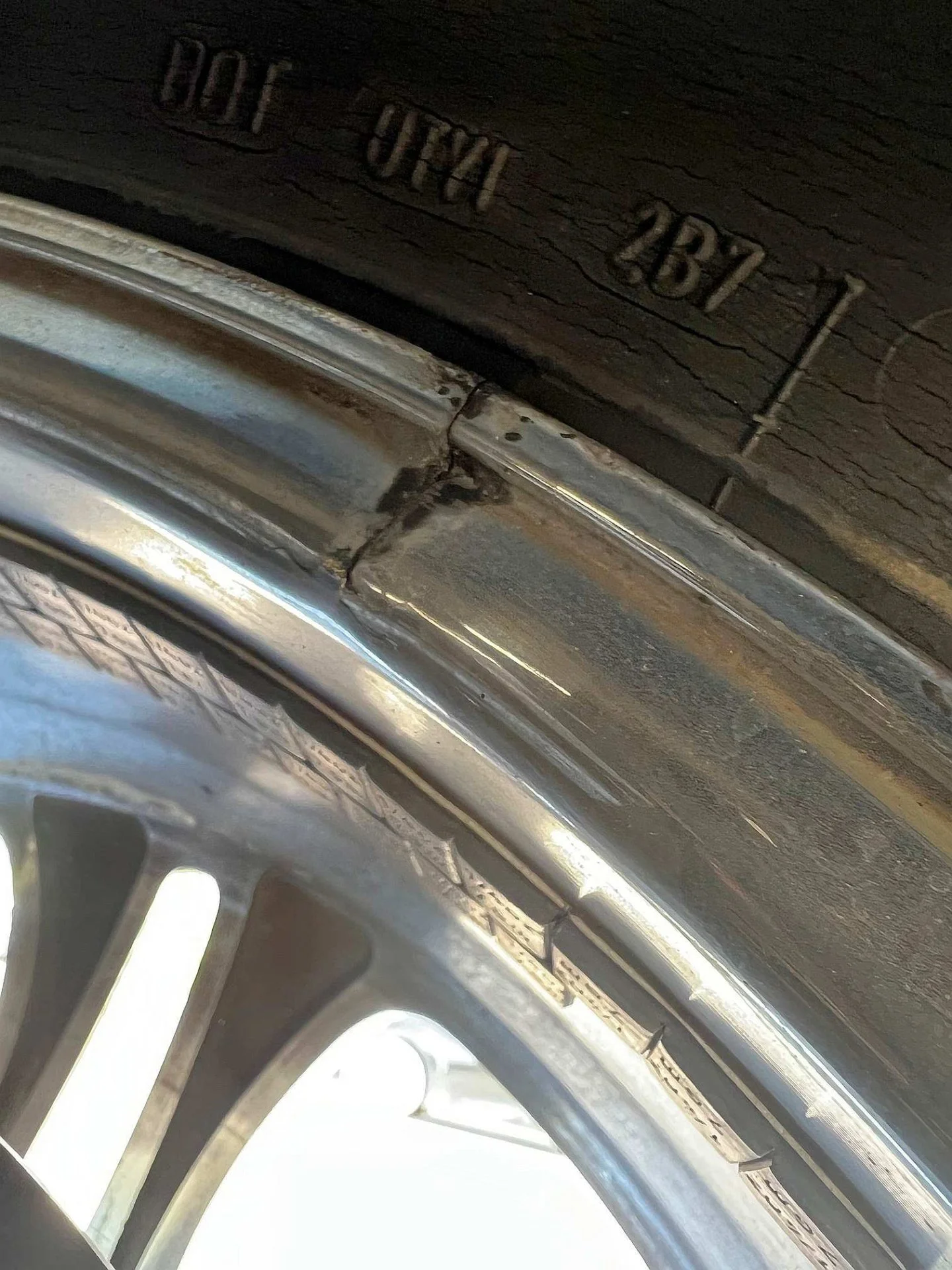

Found out it was due to a crack in the wheel itself...

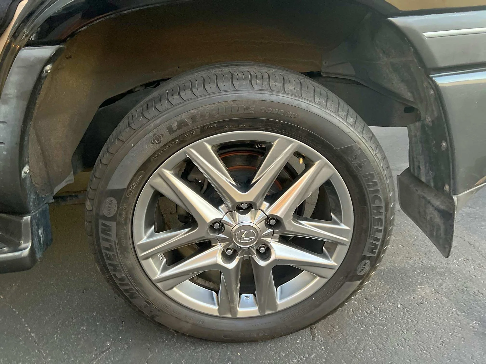

After a quick trip to a local IH8MUD member’s garage I got a nice full set of replacement wheels.

That's a lot of issues on day 1, especially for a low-mileage vehicle. Those tires look old. Definitely a good idea to get that problem out of the way first. And, obviously the cracked rim(s).
FYI, that's not a 2004 grill. It's a pre '03 grill.... and I don't think they are compatible.
Arizona heat, believe it or not date code says they're only 3 years old. No rust, but damn does it turn rubber brittle quick.
