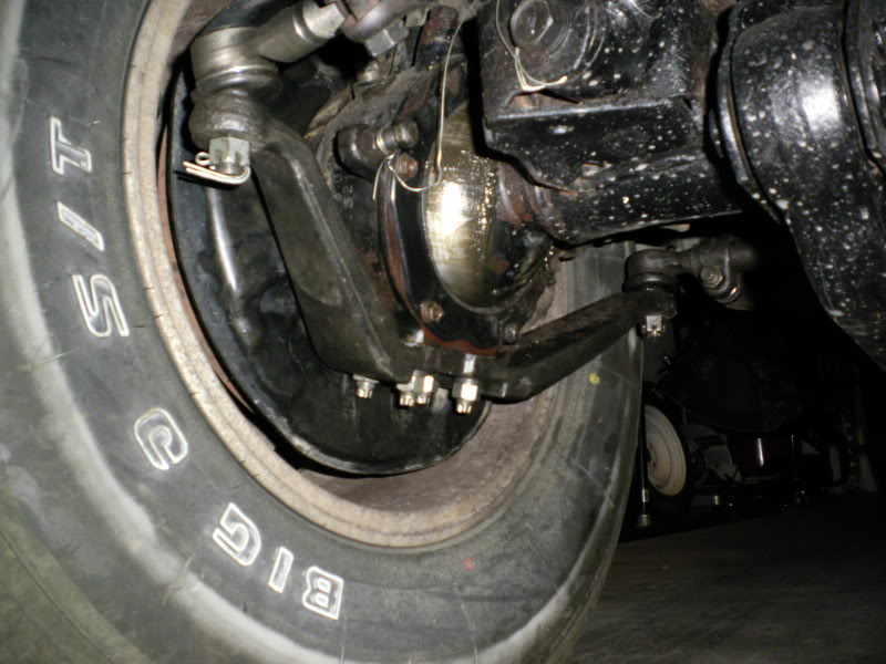

Spent this afternoon pulling off the twisted steering gear, should have time this weekend to install the new one:)

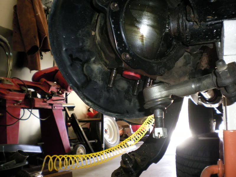

Got the new steering gear in this weekend...I can now make full turns left and right :lol:

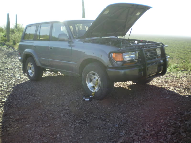

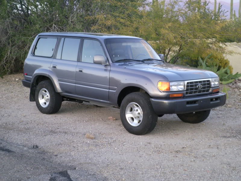

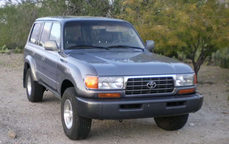

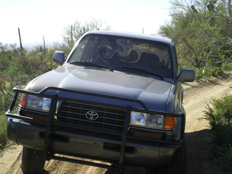

Took the Cruiser out on a little shake down run... We did a little over 80 miles on the dirt with no real issues. I learned that the under mounted spare tire drags on everything. I also drug the lower part of the brush guard on I few spots, so I guess that needs to come back off... Too bad since RockJock82 was kind enough to give it to me. We didnt take many pics, I am bad about that:o But here are a few.
While climbing this I got a flat:doh: a nail from the boards laying on the left side of the road I guess??
Lucky for me I had my plug kit and compressor:cheers:

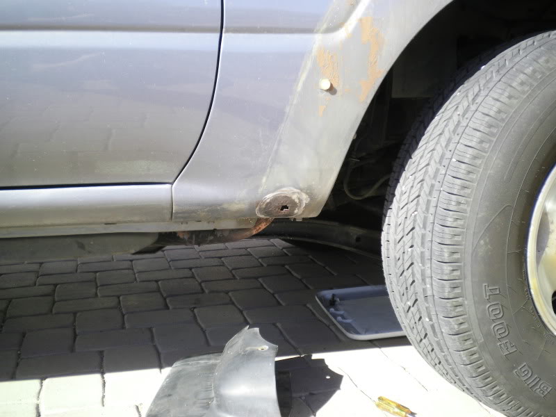

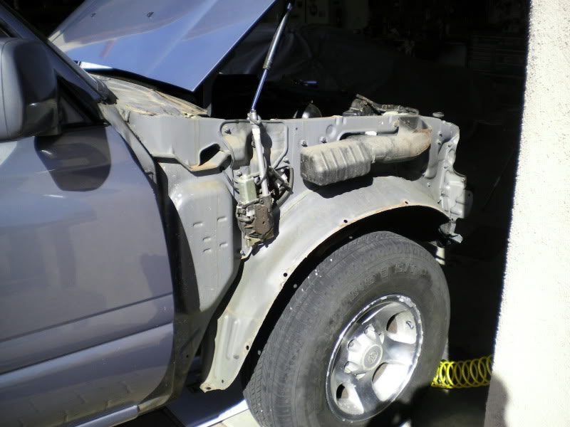

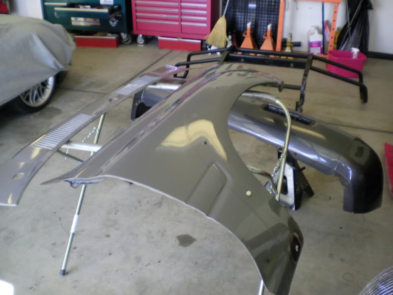

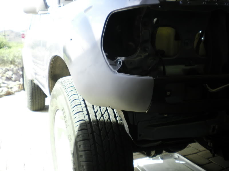

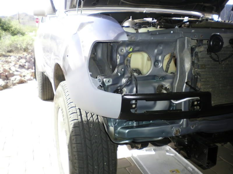

I decided to go ahead and try to fix my body damage on the fender myself. One of the body shops I deal with offered to fix it and paint it for $200.00 but hell I can use that money for my lift or winch or bumper ect.... so hell with it....its getting a primer job for now:D Its a off road truck not a show truck. Hows that go..paint and chrome dont get you home.
This is what I started with.

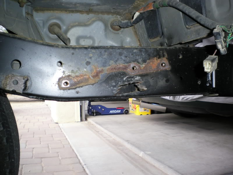

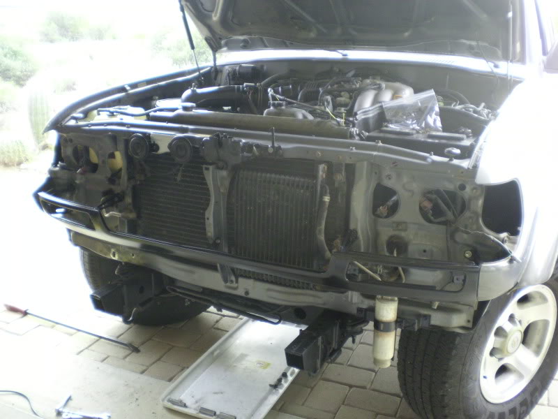

Pulled all this crap off for the 10th time..
Good news no damage or rust here..
BTW.. I am not going to run the brush guard so its free:

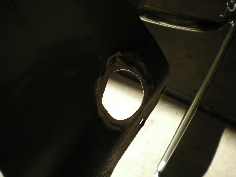

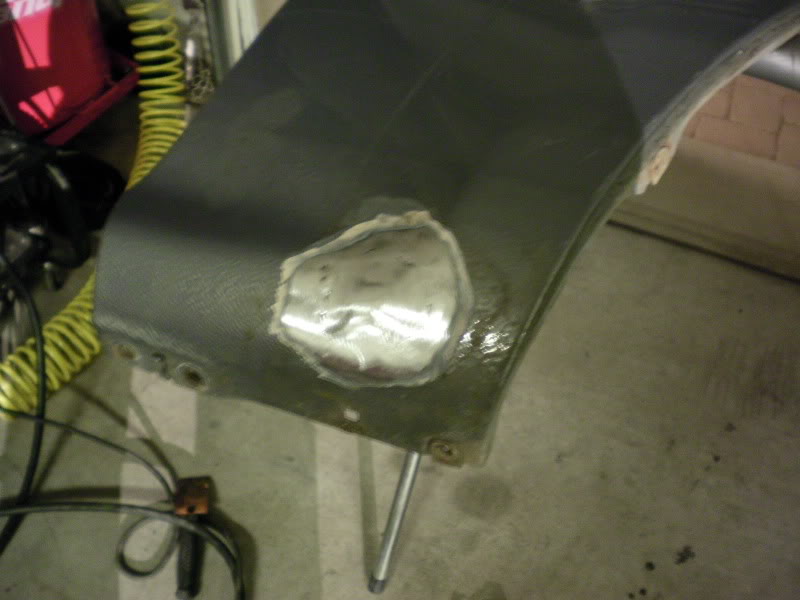

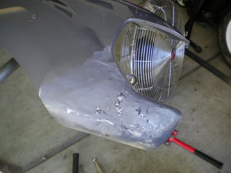

15 min with the hammer got me this..

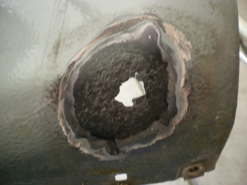

Cut out the rust on the lower part of the fender..
So now I need to cut a patch out and weld it in and hit the top of the fender with some body filler and primer.
More to come:cheers:

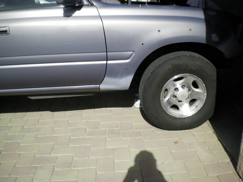

Patch welded in no more rust in this fender;)
Fender test fitted and looking ok for a non body man:lol:
The paint I had Napa mix wasnt even close...so I will take it back and just let my body man from work paint it:D

Got the fender and valance on..paint isn't a great match but this isn't a show truck :cool:
Haven't put the flair on because I am waiting for the trim tape from the dealer.

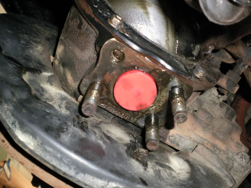

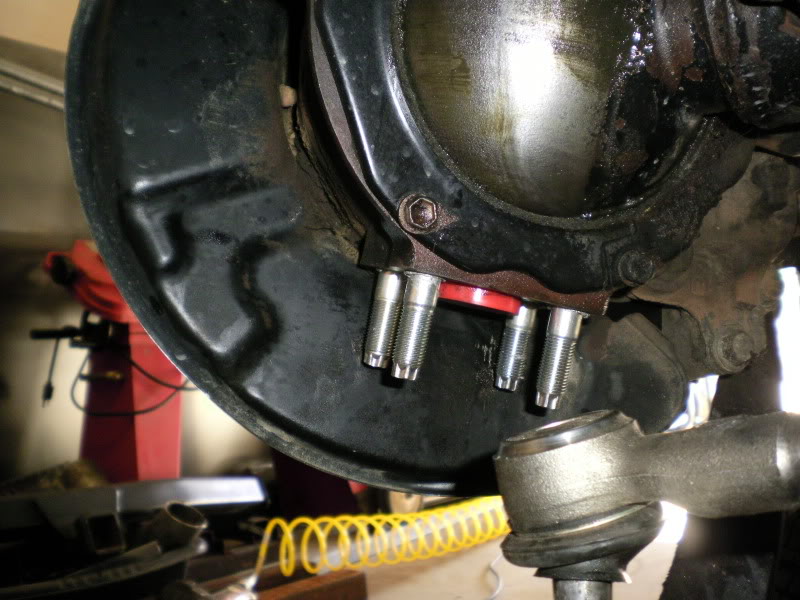

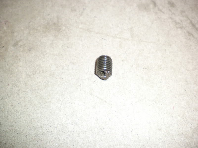

Got around to replacing the broken stud on the knuckle...came out with no issue....lucky for me:grinpimp:
Now let the lift and bumpers begin :steer:
