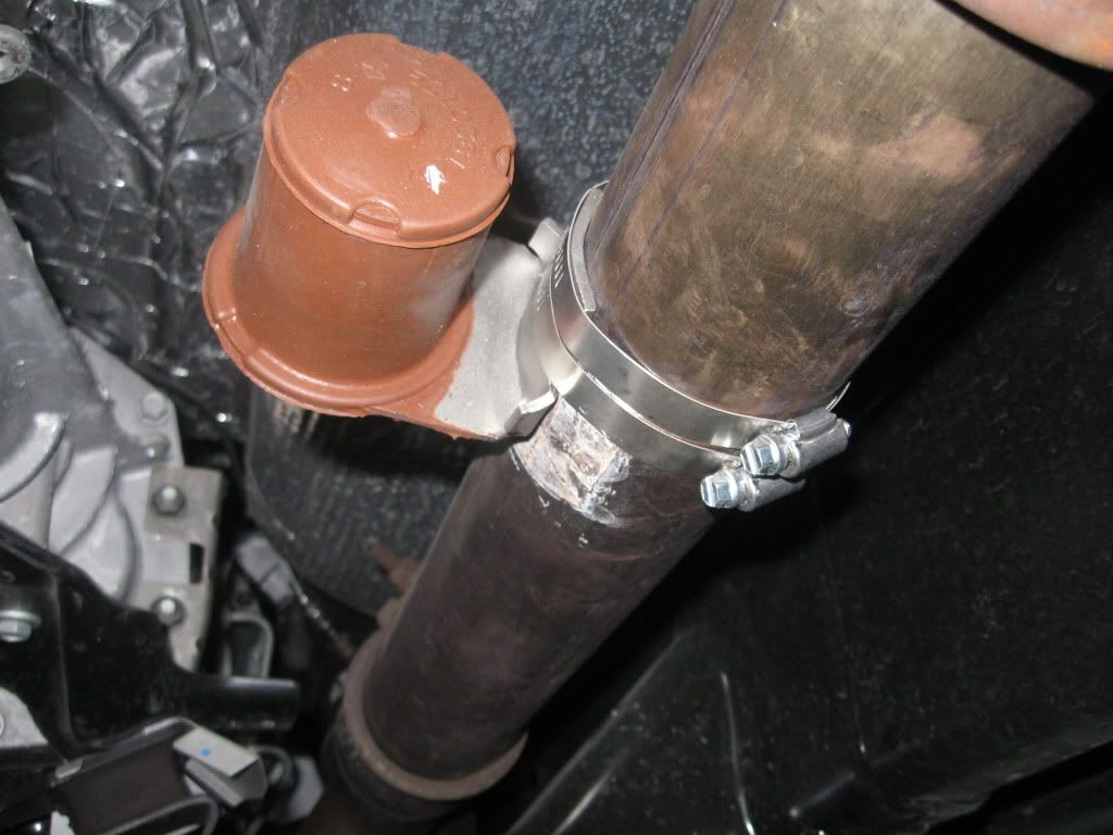

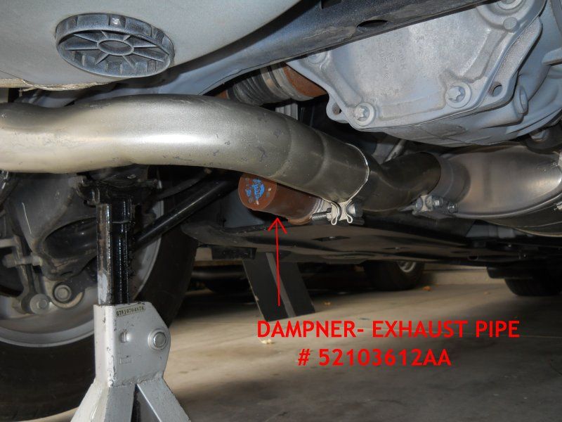

You can add one of these dampners- its a Mopar part, about $20.
Part No.: 52103612AA
DAMPER-EXHAUST PIPE
52103612AA - Genuine Mopar DAMPER-EXHAUST PIPE
Youll need an exhaust clamp to hold it- its heavy rubber.
(This is not my exhaust)

Ive been playing with one of these mounted in different lacations. Currently mounted just in front of the muffler. Maybe my imagination, but its smoothed out a vibe/resonance I get at 2000-2400 rpm at hwy speed.
