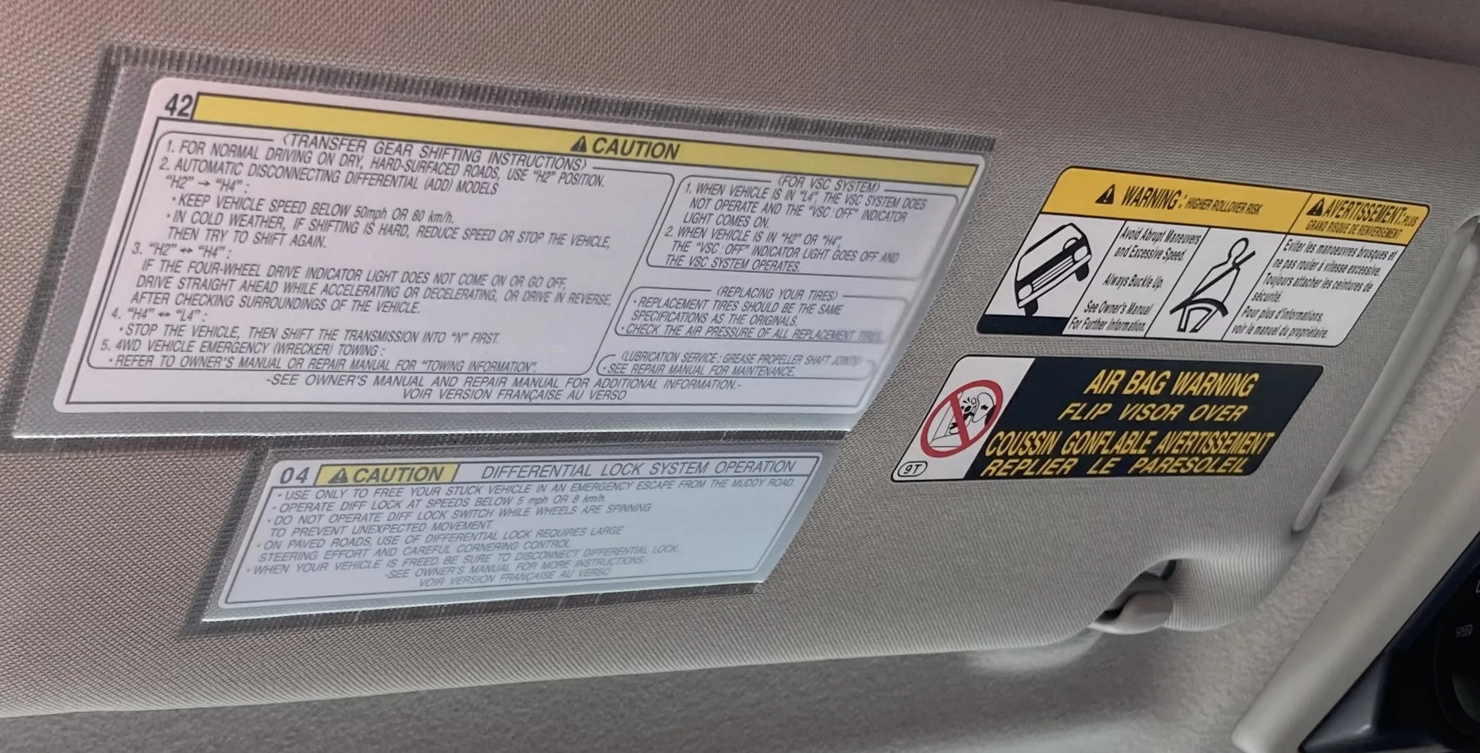

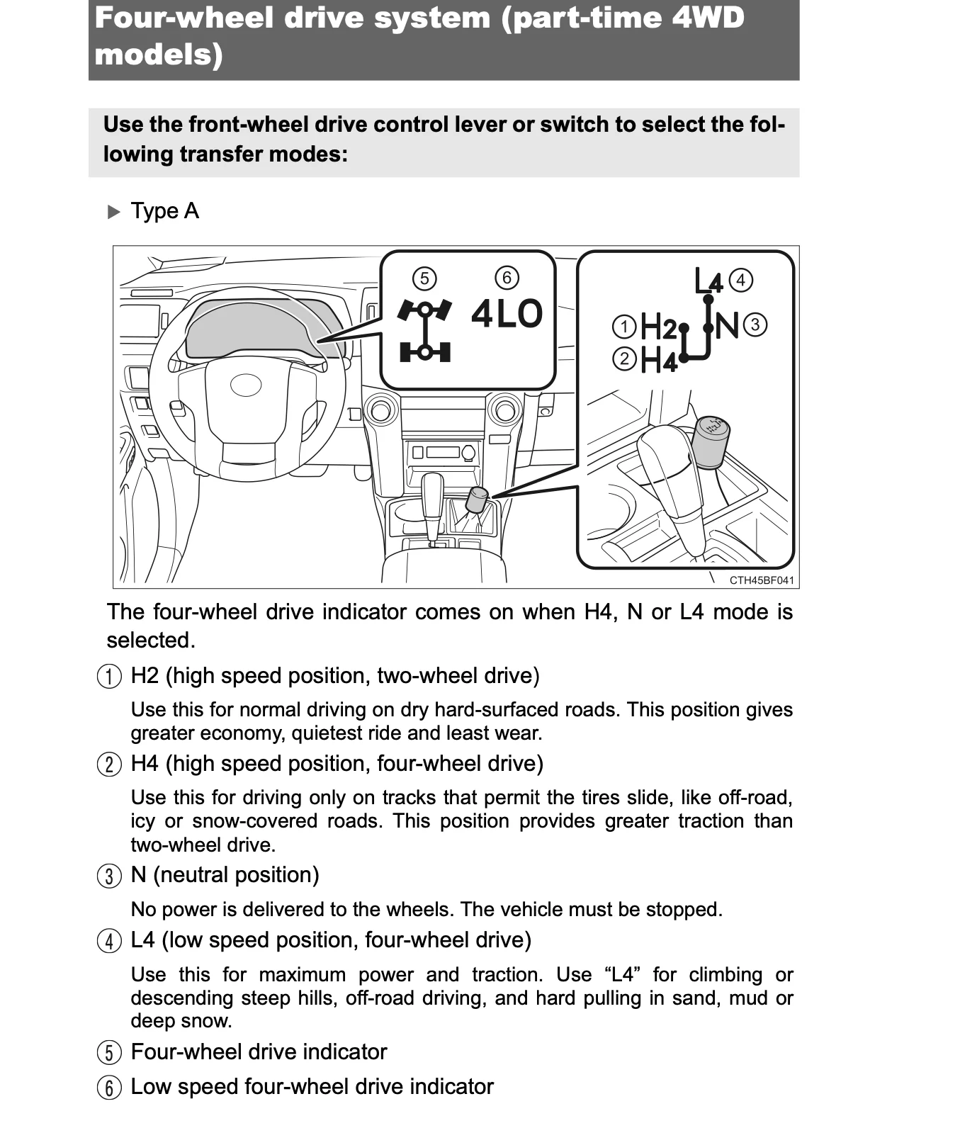

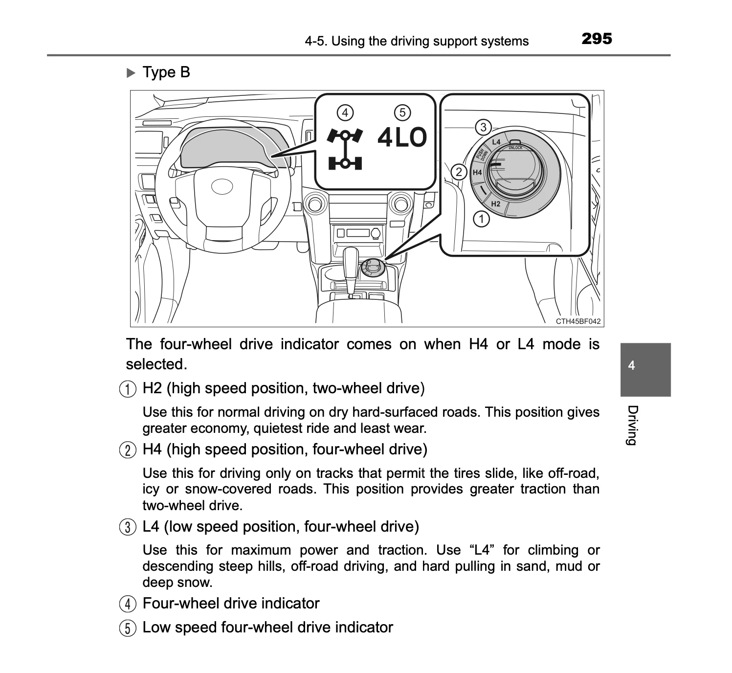

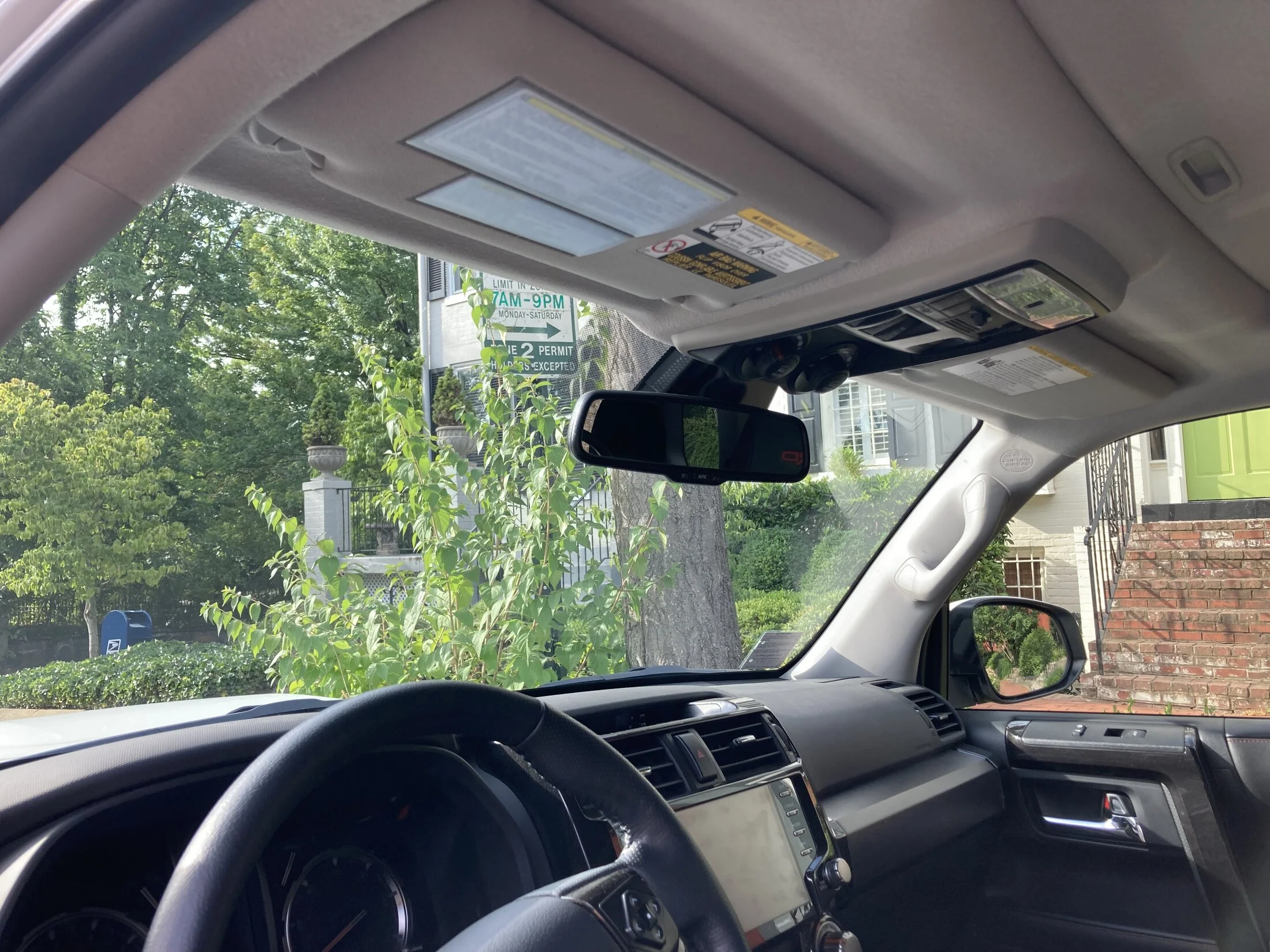

Also, look to see if you've got an info card in the driver's side sun visor. The key piece of info on mine is to keep it under 50mph if using 4hi... and it's 62mph if you have a dial instead of a manual transfer case lever. The owner's manual has a further breakdown on the use of 2hi, 4hi, 4lo, etc.
2024 4Runner Owner's Manual
