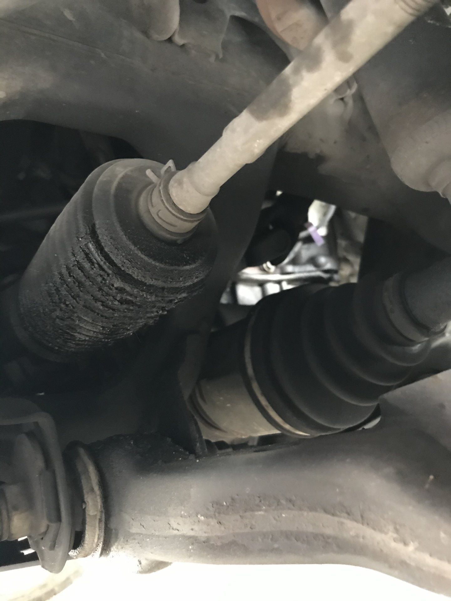

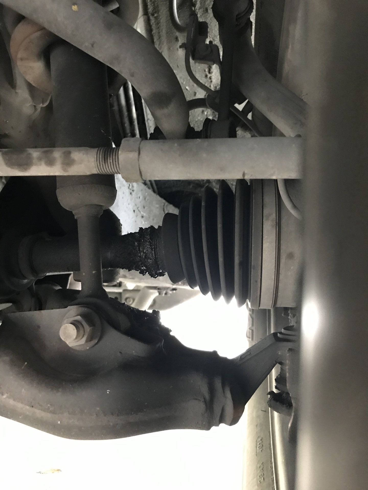

The person that looked at it told me that the rack and pinion were due for a change but that could wait. This is what I’m seeing under the truck
Your driver's side CV is wetting the bed. I doubt its your rack too. My passenger side just let go yesterday :(.
For MPG's, check the heat coming from the brakes after driving, my bet is the driver's side is hotter than the passenger side. If you have a cheap HF infrared thermometer, use that to measure the difference between the sides. This would answer the poor MPG's and the pulling left.
Yeah it is :/ I’m going to replace the boot on both the rack and the joint ASAP. I’ll check out the breaks too !
