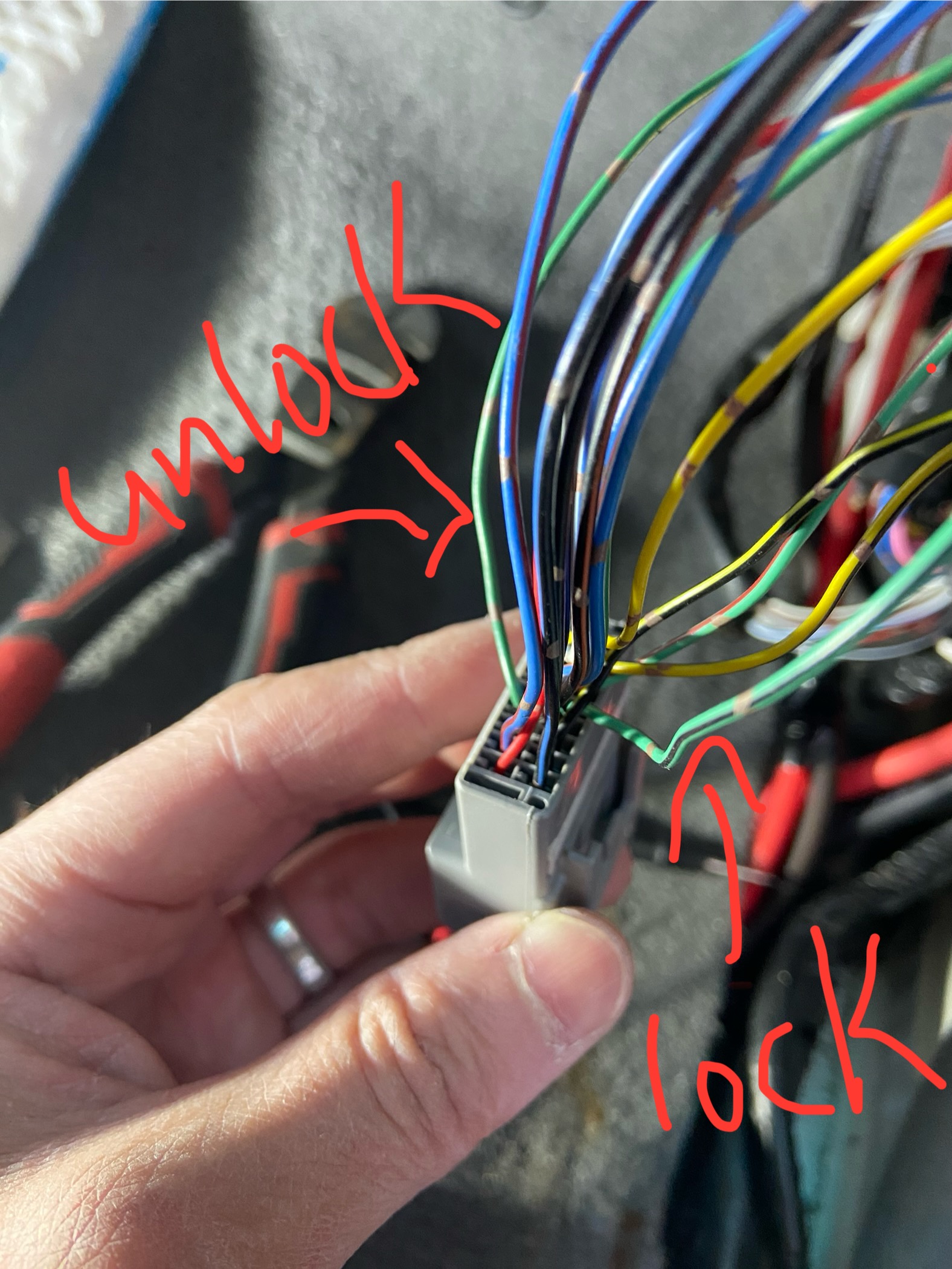

Just did this install along with the mycar module. However, I am having issues with the lock and unlock function. The app is able to unlock but does not lock. On the wire diagram from MPC, it says its the green/blk wire which is what is tapped into. Any ideas?
Figured it out. The door lock wire is the black/orange wire (beside the green unlock wire) on that pin connector on the passenger side. The instructions by MPC were wrong.
