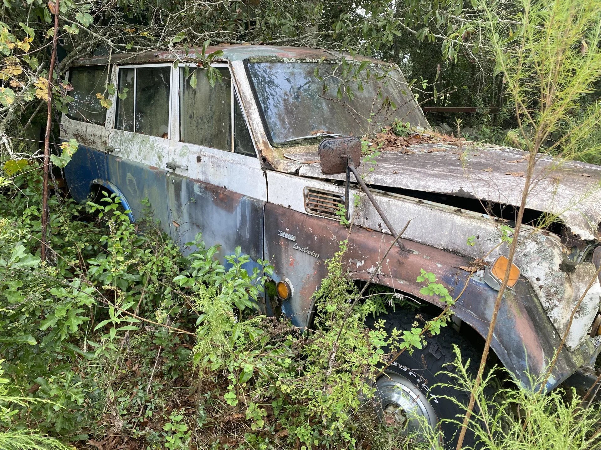

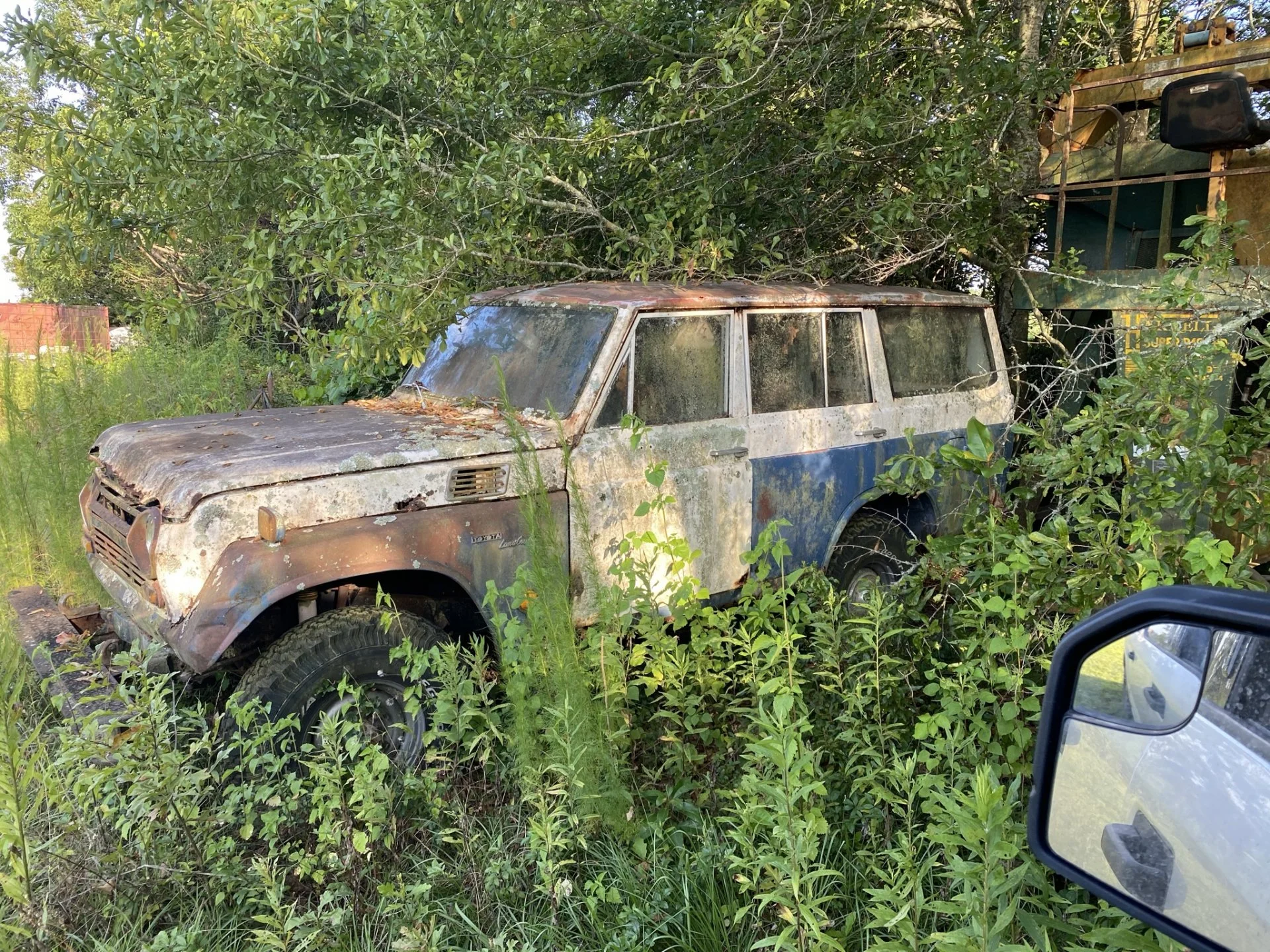

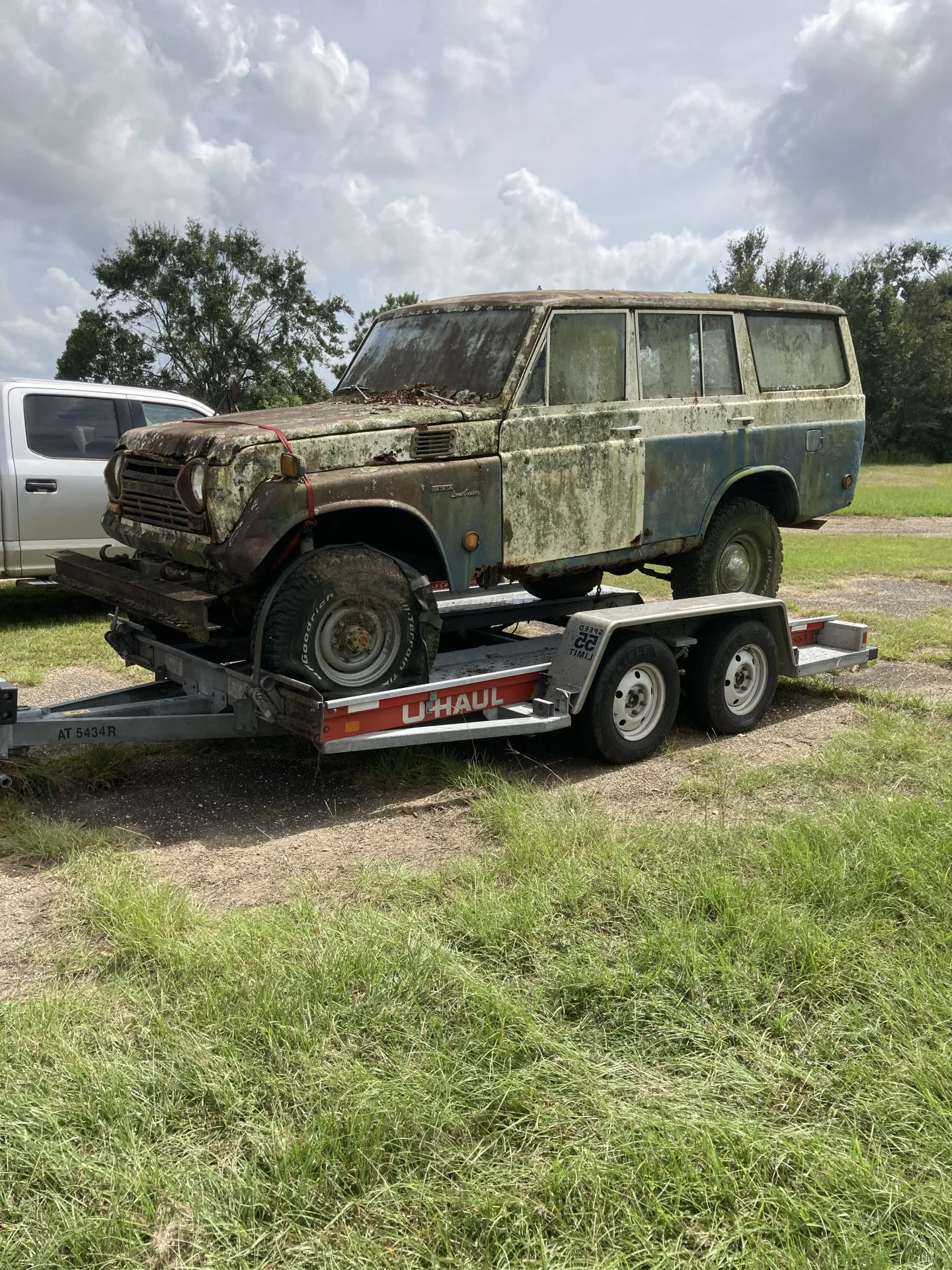

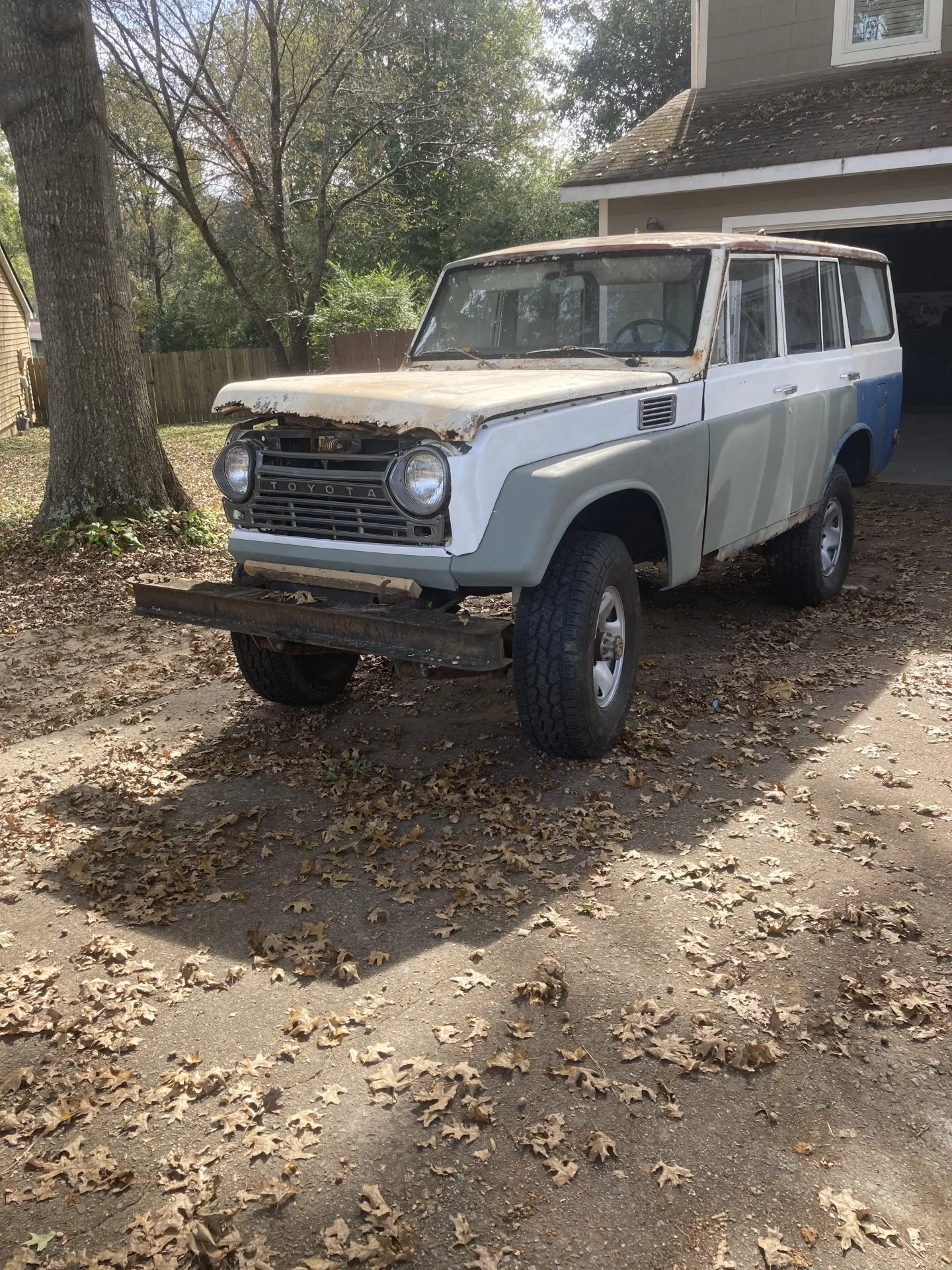

In short: I answered a posting on 'Mud to pick a free FJ55 in the fields of South Alabama. I was lucky to be the first to respond and in a couple of days I was on my way down to get him. This is how he looked:
I got him loaded on the trailer and headed to home... After a quick visit to Buc-cee's.

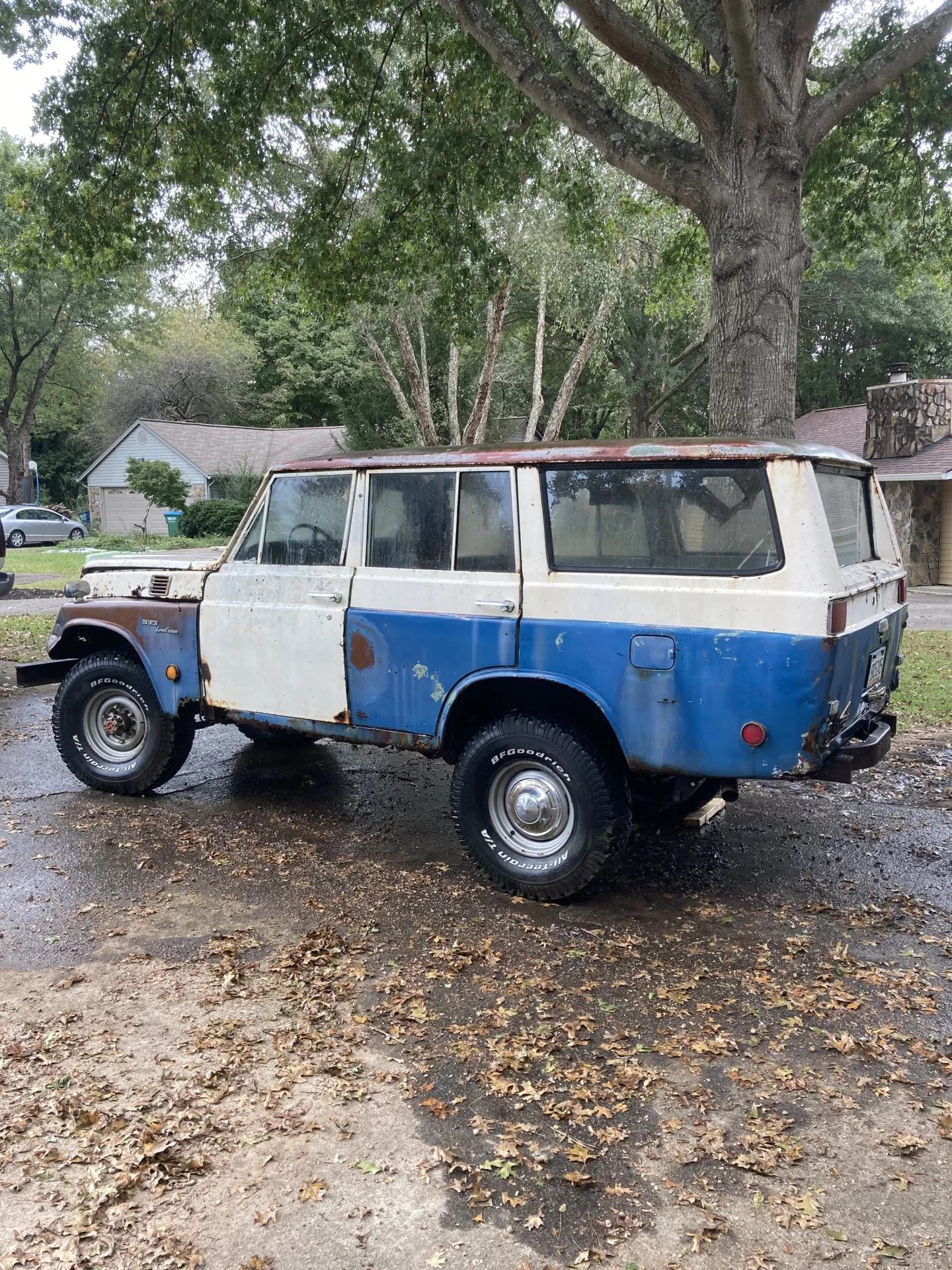

Once home I pressure washed and began repairing as much as the body as I could. Started to look decent:

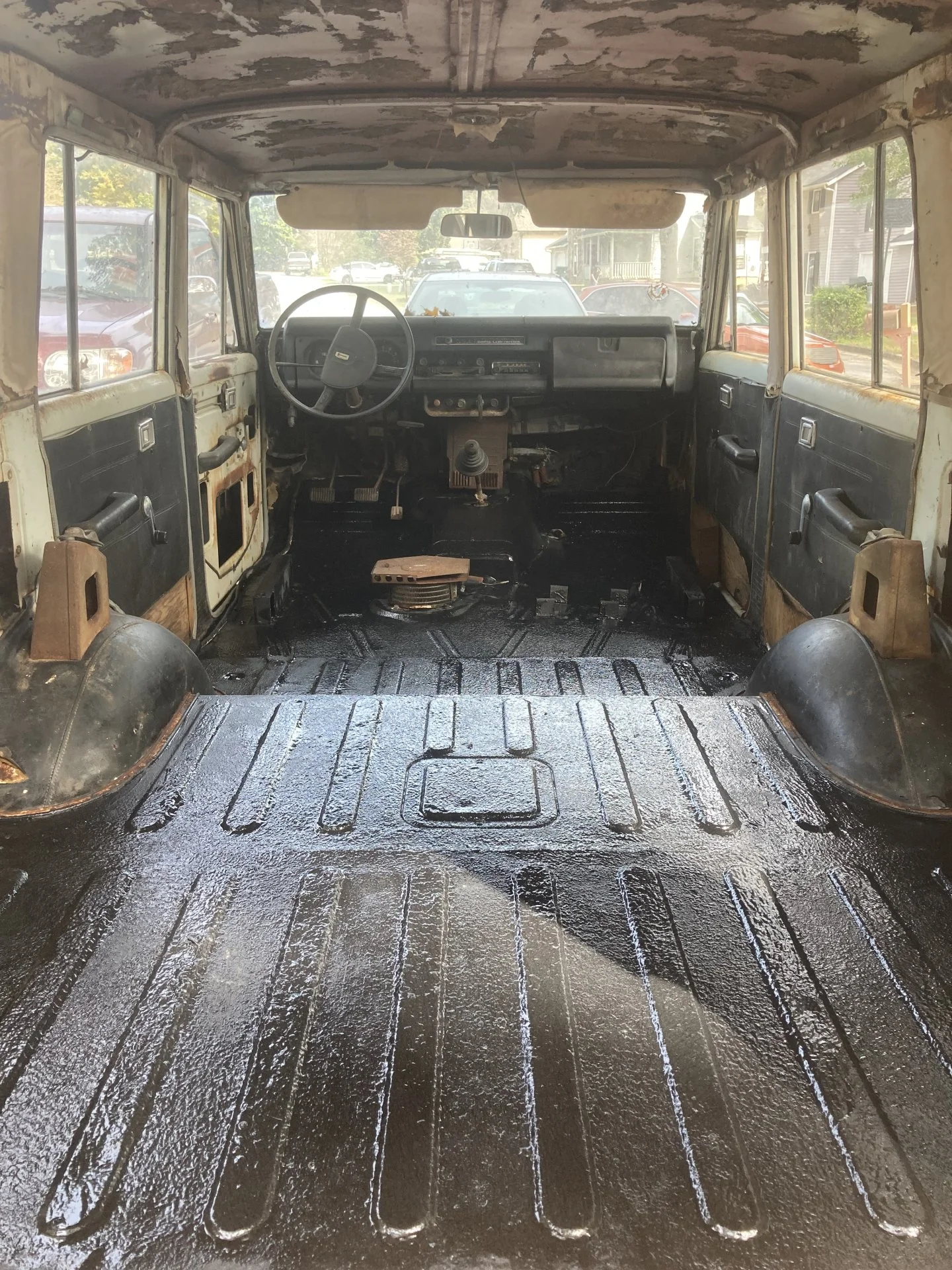

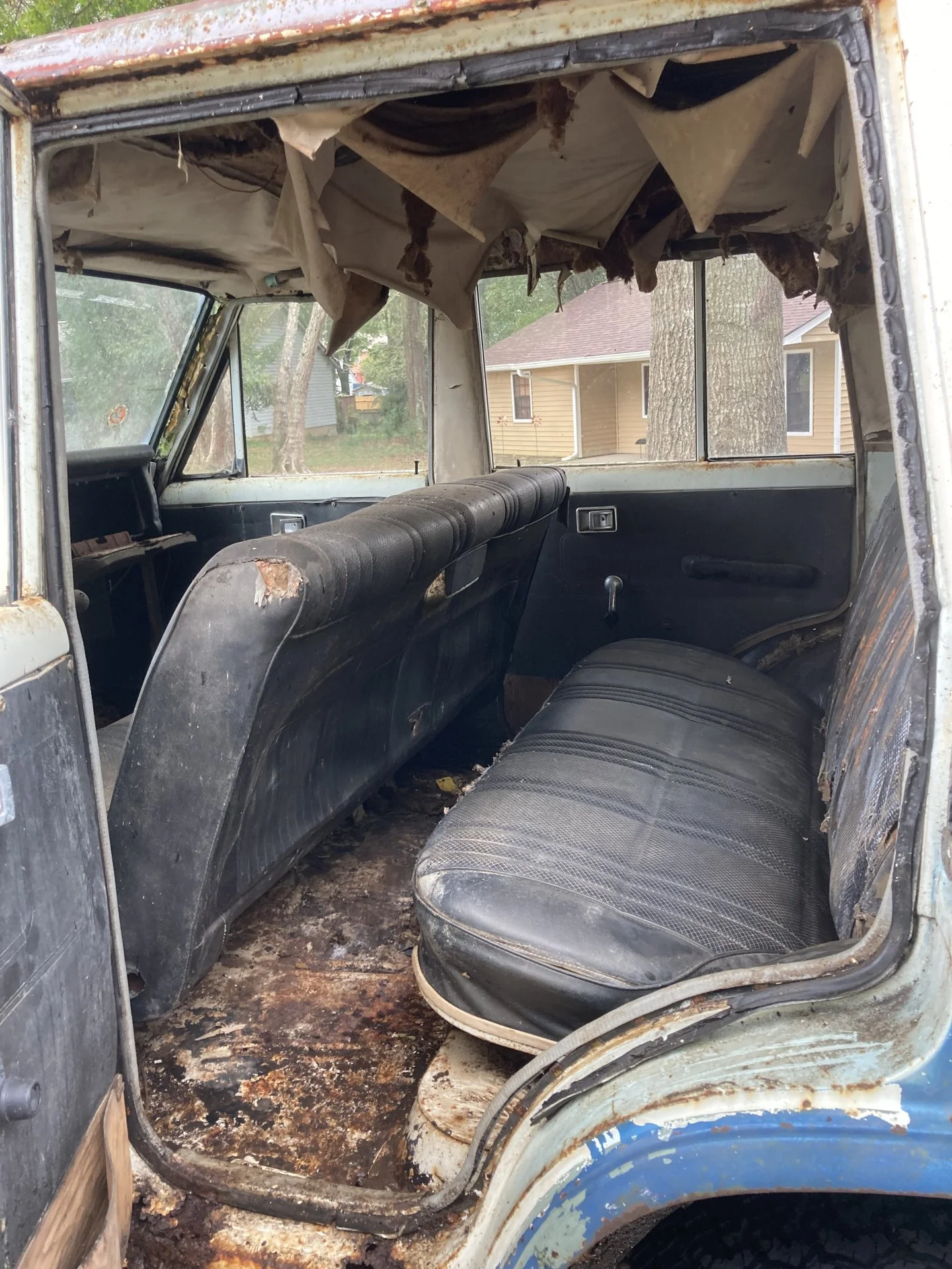

Interior:
The inside was trashed. A few critters had made it is home and treated it like a large toilet.
I quickly pulled everything out. Patched the rust holes and put down truck bed coating with added heat/ sound additive and later covered with 50 mil sound deadening mat:

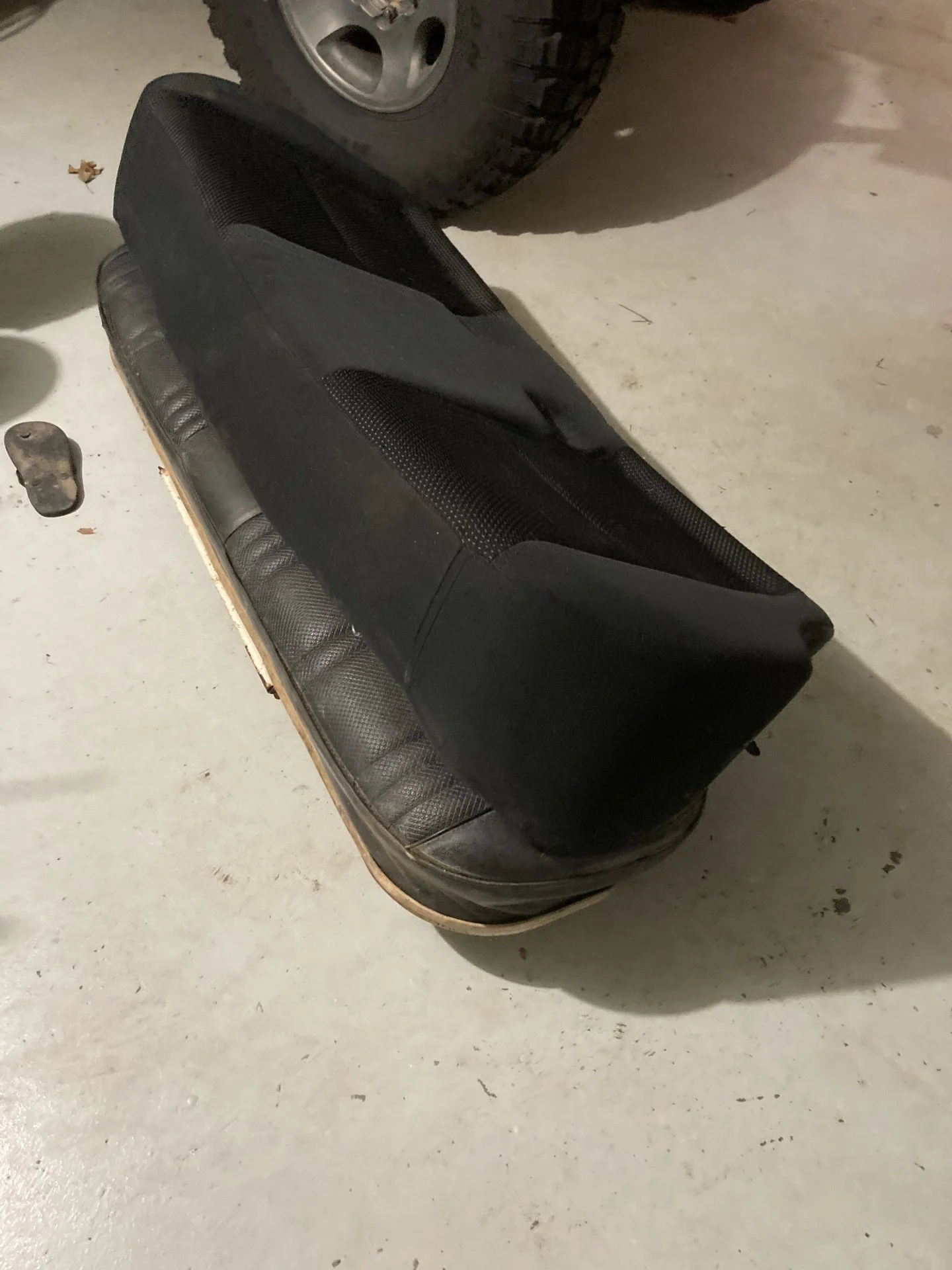

For seats. I wanted something comfortable, cloth and black. Turns out Scion XB seats were designed with FJ55's in mind. Rear seat was almost identical:
And fit in quite nicely using the stock mounts so it still folds down flat:

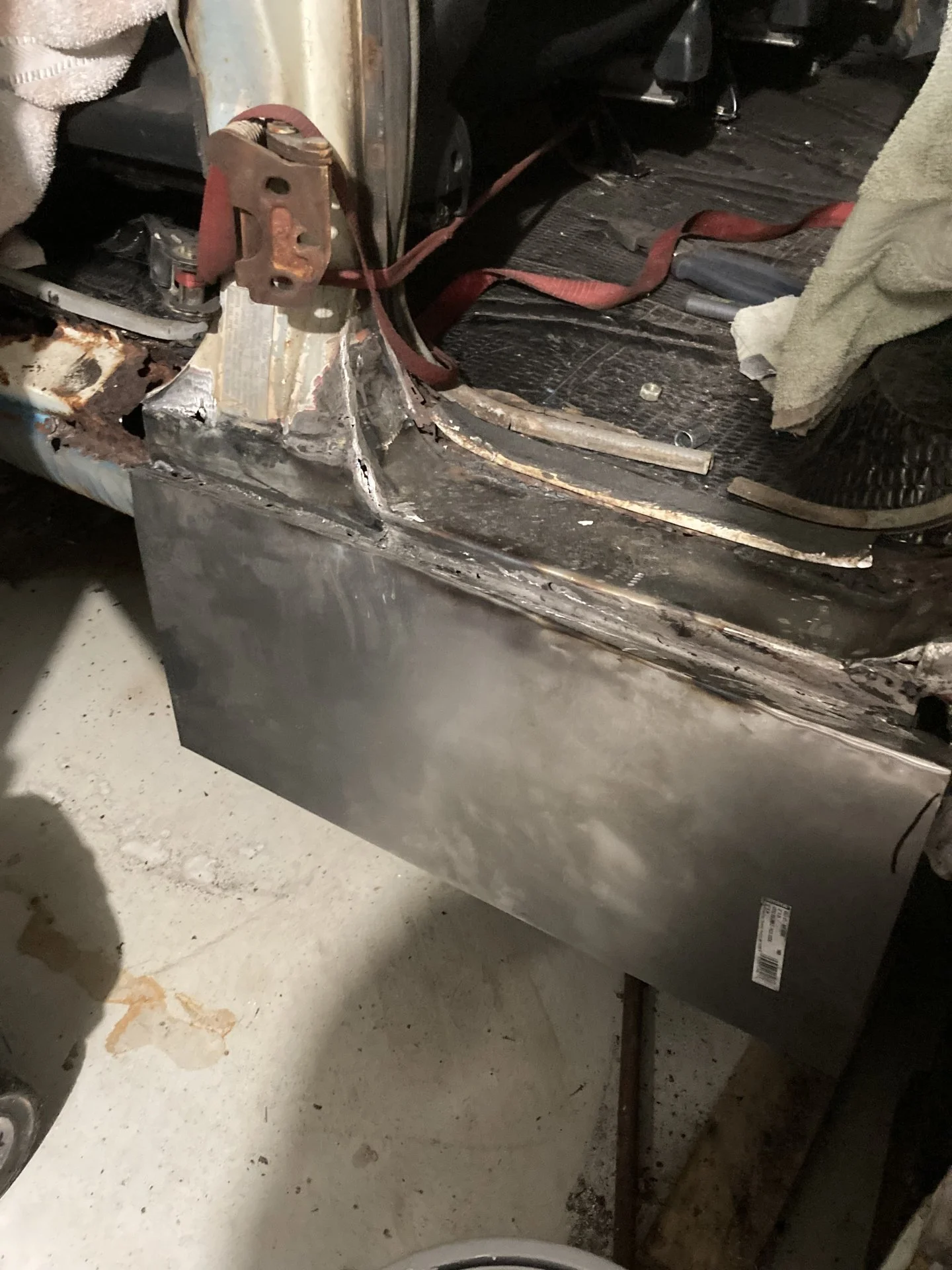

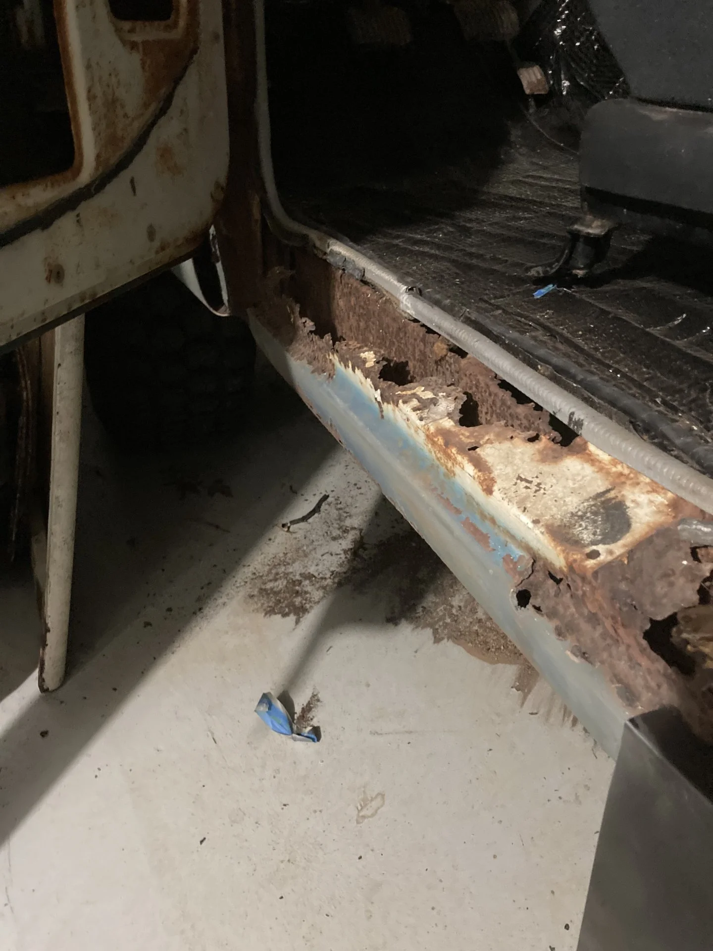

Not quite hardcore yet. I know. But some of the rust repairs have been horrendous. The B pillar on the drivers side was completely loose. Only hanging on by a little steel connected to the roof. So rebuilding that with the rocker panels:
