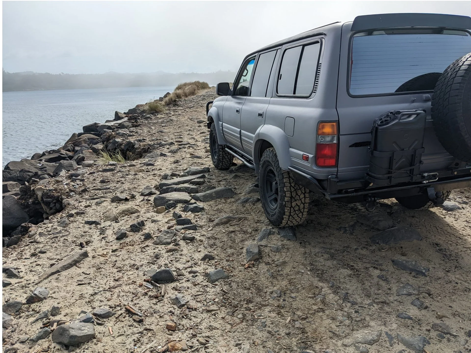

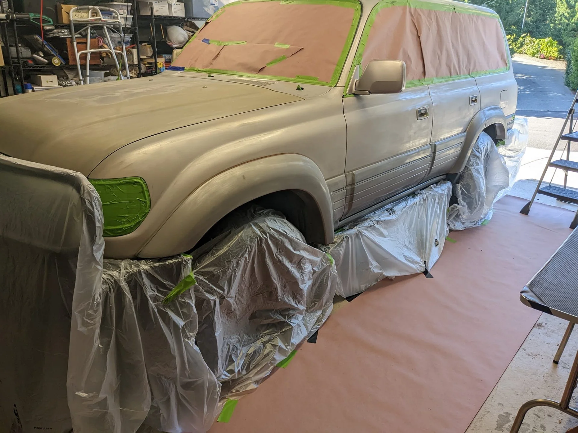

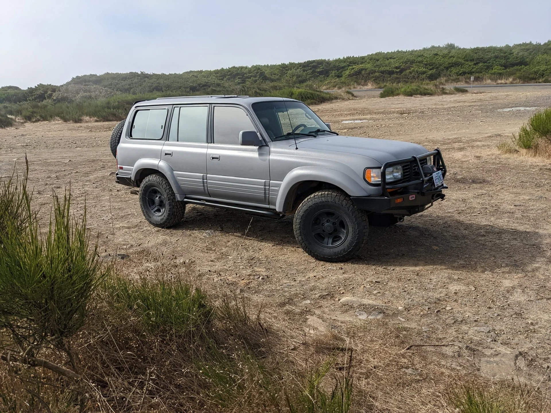

My lx450 has been that champagne color forever , and after owning it for years I finally changed the color to medium gray in Monstaliner! It was very easy to block sand and mask off and "rolled" really well ! all toll with extra rollers, sandpaper, etc. less than $500 for material and 3 days work , 2 prep days, 1 day coat.

About 1 and a half gallons , used the other half gallon on a utility trailer ! So buy 2 gallons for sure ! Make sure all the shine from the old paint is off , and solvent rinse the body off , I used acetone , then roll or spray ...I rolled it ... Also know it'll probably take 2 full gallons , because I didn't roll front or rear bumpers or rocker panels , since they weren't being coated gray
