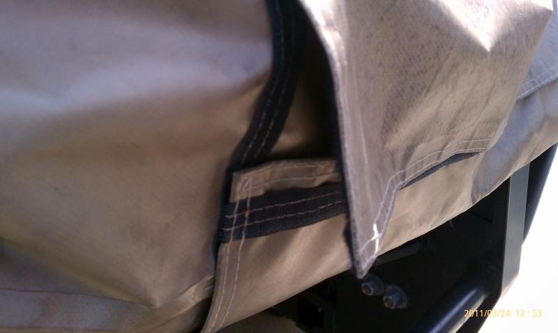

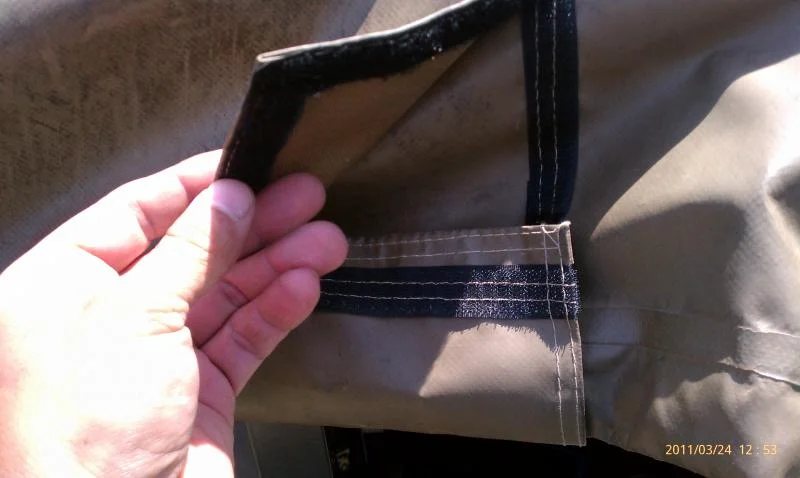

This is the problem... (velcro cover starts to flap around at hwy speeds)

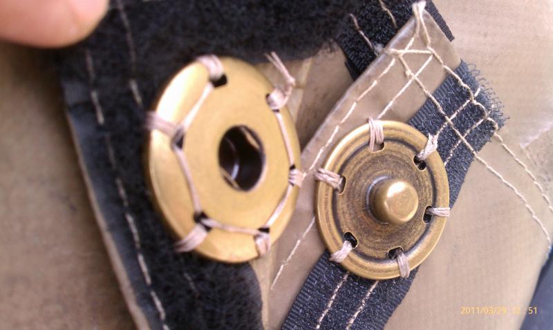

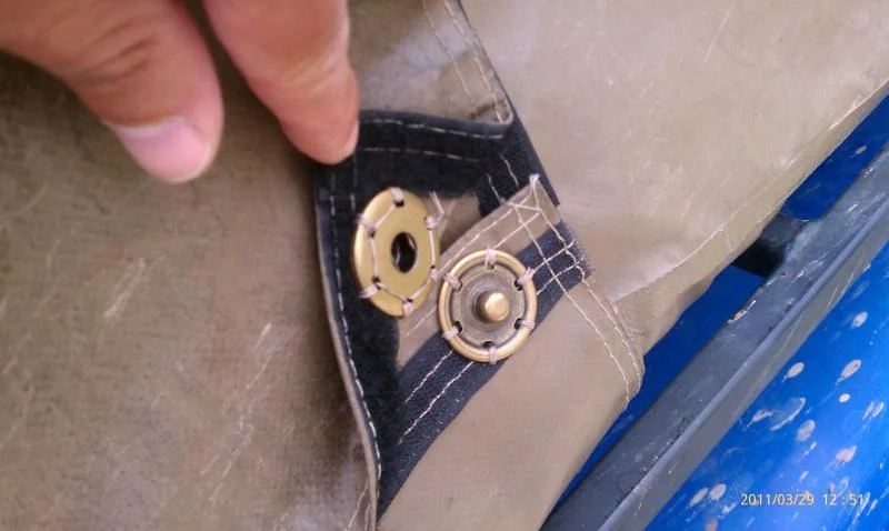

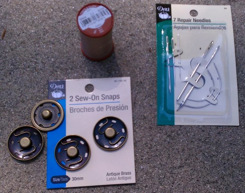

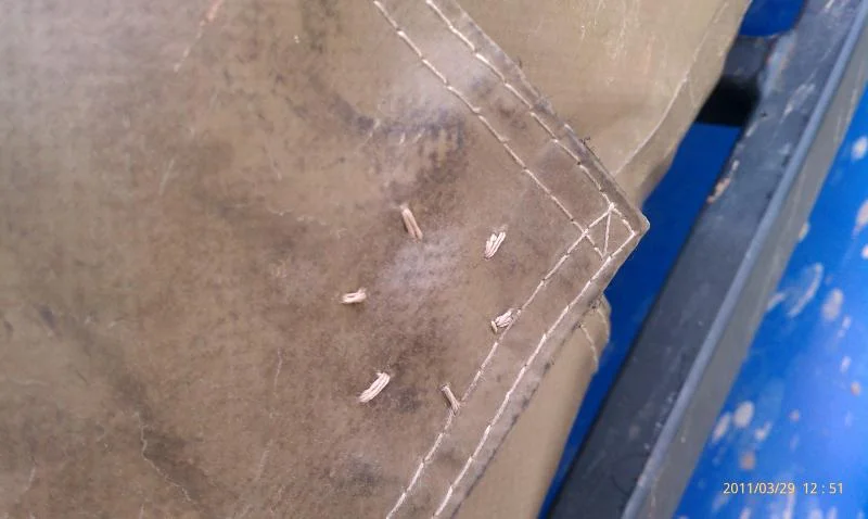

This is the solution snap buttons purchased at a crafts store....
We did an over kill with 4 buttons but I rather do this once...
I think two buttons would of been enough tho'.
