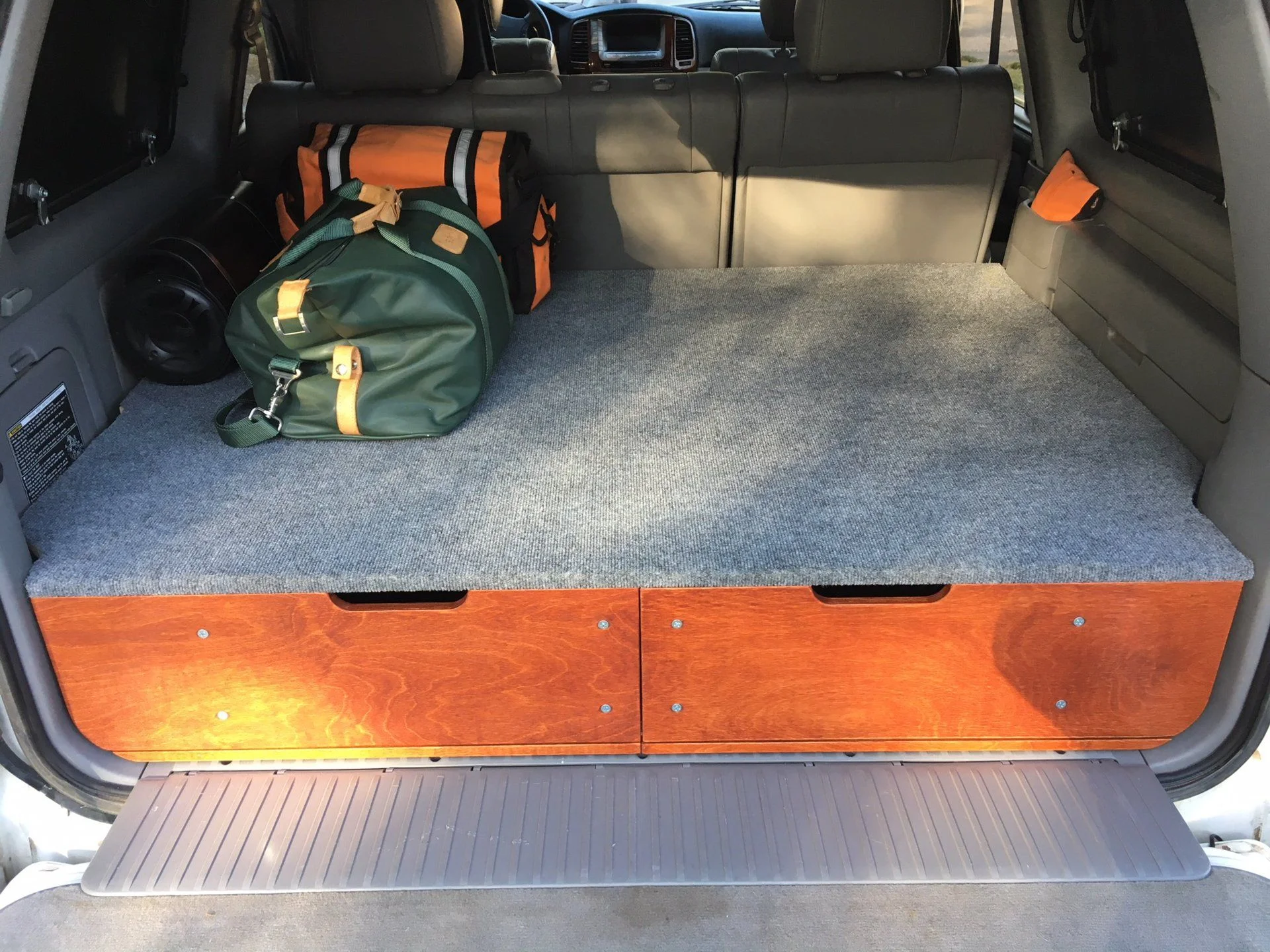

Moby is back with drawers! Recently finished a set of KISS drawers and they are fantastic. Pulled the trigger on these after my tundra was outfitted with the Decked drawers in the bed and really liked it for work. The KISS system is simple and because it is wood there are many ways to finish it. I chose carpet and stained fronts. Contact @cruzerDave for details. :cheers:
Thanks @1toy, glad you like them and they turned out beautiful! Full disclosure folks, he spent some real energy and time finishing them that nice - care to say how much of each that took?
cruzerDave, I took my time with the finish out on the fronts. I spent about an hour or two each day sanding, staining, clear coating, fitting, covering, gluing, double checking for about 5 days. Important not to rush the stain in drying process. 3 coats of stain and one of satin clear coat. each coat takes 24 hours to dry in my area (maybe more). I sanded the drawer fronts with fine grit and got them real smooth. I beveled the edge of the deck at the tailgate sanding it down just enough to stick the carpet with a couple of cans spray adhesive. What you don't see is inside the drawers some harbor freight foam mat in the bottom of each drawer which has worked out for me better than carpet.
