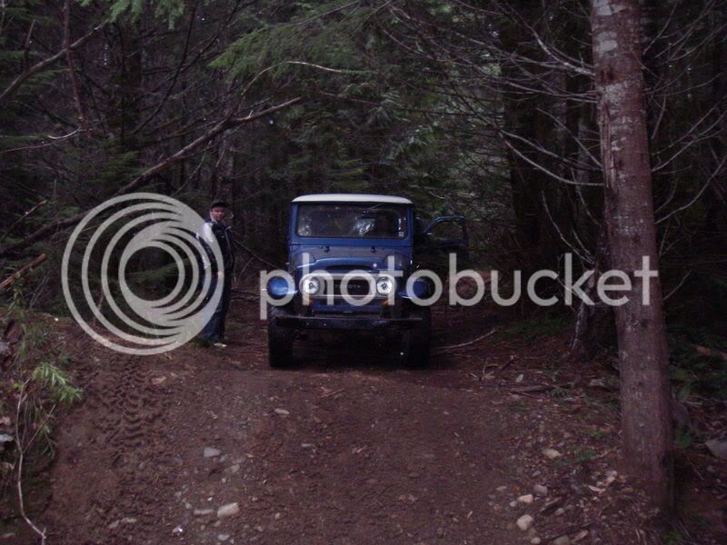

FINALLY got all my junk back togather....saginaw is done now....drove it and came home for a cold shower:hillbilly: works wicked...if i ever buy another cruiser to wheel...thats what ill be doing first. pics later. 6AM is gunna kick my ass in the morning. there are still some little tweaks i want/need to do so im happy (modify the pump mount) but the bottom line is its done and working and i grad at the end of the week so its all good:flipoff2: and im stoked
right on dude! Glad to hear it worked out for ya.
before:
now:
heres some of the swap
the tires still rub a bit but im going to try to make up some 1/4" spacers to give me a bit of room
