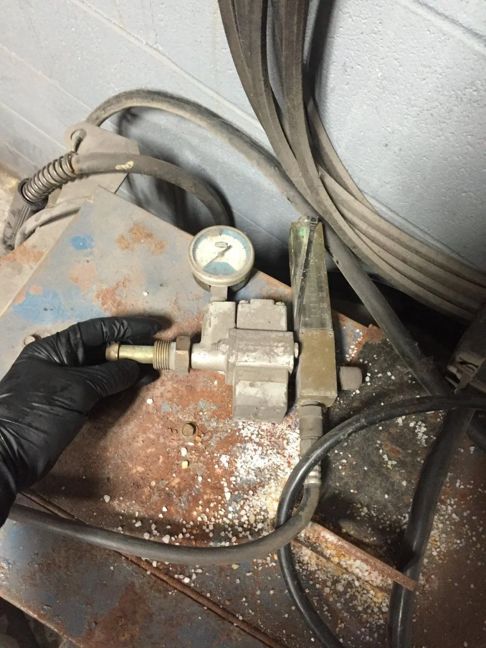

My work has a very old millermatic 200 welder. It has sat in our tool room for years. Supposedly works but leaks Argon. I was considering trying to buy it from work. Just wondered what it might be worth. And is it even worth bring back to life as I'm sure after sitting so long it will need other repairs. I would need to buy an argon tank and some Mig wire to start for it. Plus the purchase price of the welder.
This plastic gauge is where it leaks from I'm told.

If there is a leak at the pressure gauge, that'd be trivial to fix by replacing the pressure gauge ($20) or if more serious the regulator assembly which looks very old ($150 or so new for the regulator and $100 for the flowmeter - just guessing). Unlikely the pressure gauge would leak though. If it does it may just need to be reinstalled with good sealant. Flowmeter may be slightly more likely, but still could be just a connection.
I would call Miller and ask them about parts availability and you may even be able to talk to somebody familiar with the machine and who could tell you what to expect.
Jump on one of the welder forums or even the tech forum on Miller's site - there have been some threads recently about that very machine . I know the liners for that type of gun are nla unless you want to fight a generic - might have to replace the whole assembly . I wouldn't give a whole lot for it , but they are a solid machine with a heavy transformer - which means you'd better be able to supply a solid 50+ amps for it on 220v . Is it single or 3ph ?
