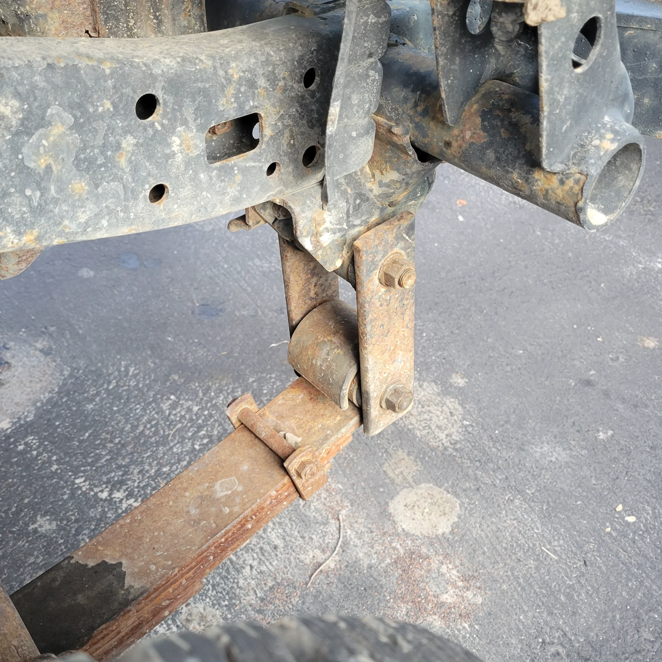

Morning friends , I'm looking for some guidance . I have a old piece of crap pzj 75 , it's my hunting and firewood hauling unit . It is a ex abused mine truck , my question is did I install the front leaf packs backwards? Is the military wrap supposed to be at the rear spring hanger ?. I had a leaf pack that had a few broken leaves in it so I swapped out the fronts for some others that were included with some spare parts that came with this fine looking unit . I did the swap but have recently acquired a death wobble now and again . I know the spring eye bushing were rough so that could be my issue also but I wondered if I maybe changed the caster angle some too if the springs are reversed? The new packs I put in were not exact copies of the ones I pulled out , but they were close to the same length but they are quite a bit more arched than the old ones too .
They are backwards. The double wrap eye end is supposed to be at the end connected directly to the chassis with no shackle.
