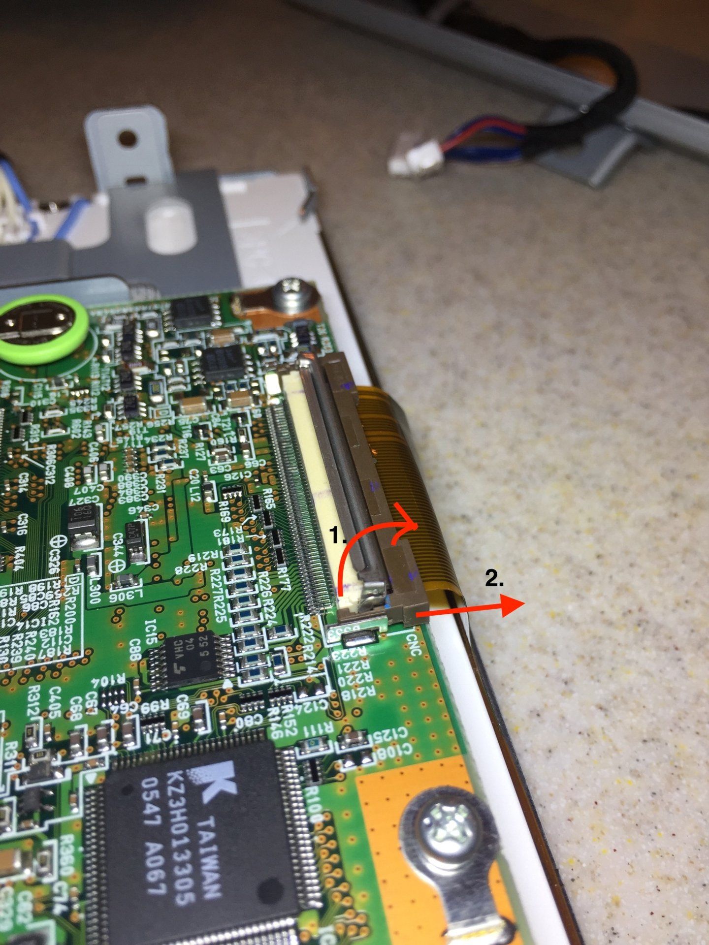

Hey @Higgin - The screen came in today, so I swapped it out and everything works! Super easy, will take you about 1-1.5hrs if you take your time.
This is the screen I ordered for $80 - LTA070B054F Navigation 7-inch LCD Screen TFT Touch Panel Display Toyota-Lexus HB | eBay
As far as I can tell it's an OEM Toshiba screen.
The only thing that took me some careful experimenting is the actual ribbon cable connector. After I figured it out it came apart and back together very easily.
I took a picture for you. First, lift the little metal bar up, and then using a small screw driver or plastic pry bar, push the brown plastic bar out towards where the ribbon enters the connector. That loosens everything up, and you can pull the ribbon out.

@olivertwist Hey, I just wanted to say thanks again! About a month ago, I got my new screen from the Ebay link that you posted. Finally got around to installing it yesterday. Works like brand new! Took probably a hour and a half going my normal turtle speed. Thanks for the tips. Probably would of figured it out eventually, but that saved a lot of time. While I was in there, I also installed the Vais Bluetooth module, so now I can use my phone to stream music and control it using the factory system.
For anyone replacing this screen in the future, make sure you have a JIS tipped screwdriver on hand. All the screws you have to remove and put back together are all JIS. I used a JIS #2 size and it worked perfect. JIS screwdrivers can be hard to find in the states, but I have a few on hand that I bought from Amazon for working on my Honda and Kawasaki motorcycles. You CAN make a phillips head driver do it, but there is a fairly high likely hood you will strip a screw head out and good luck trying to find another!
