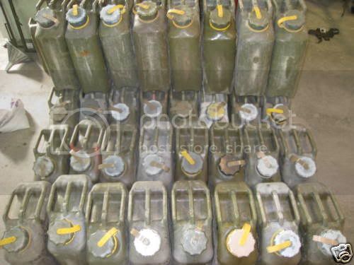

im trying to get this used fuel cans, does anybody know how to clean them if theyre used for deisel . Im using it for gasoline and dont want to mess up my engine. heres the pics of it.

:rolleyes:Just make sure they are clean inside and drain out as much as possible. A bit of diesel won't hurt your gas engine. Think about the dilution ratio here. 128oz to the gallon. What, maybe 1 oz could stick to the inside of the can. You have 5 gallons of fuel so that is a 600:1 dilution. Your truck won't notice it.
What really needs to be done is to swap that diesel only gasket to a gas compatible one. That is much more critical.
No issue using cans for gas. I use my cans for both gas and diesel all the time. Dilution is your friend!

im getting the one with viton gasket, so cleaning it with gas will put me on the safe side , thanks alot.
