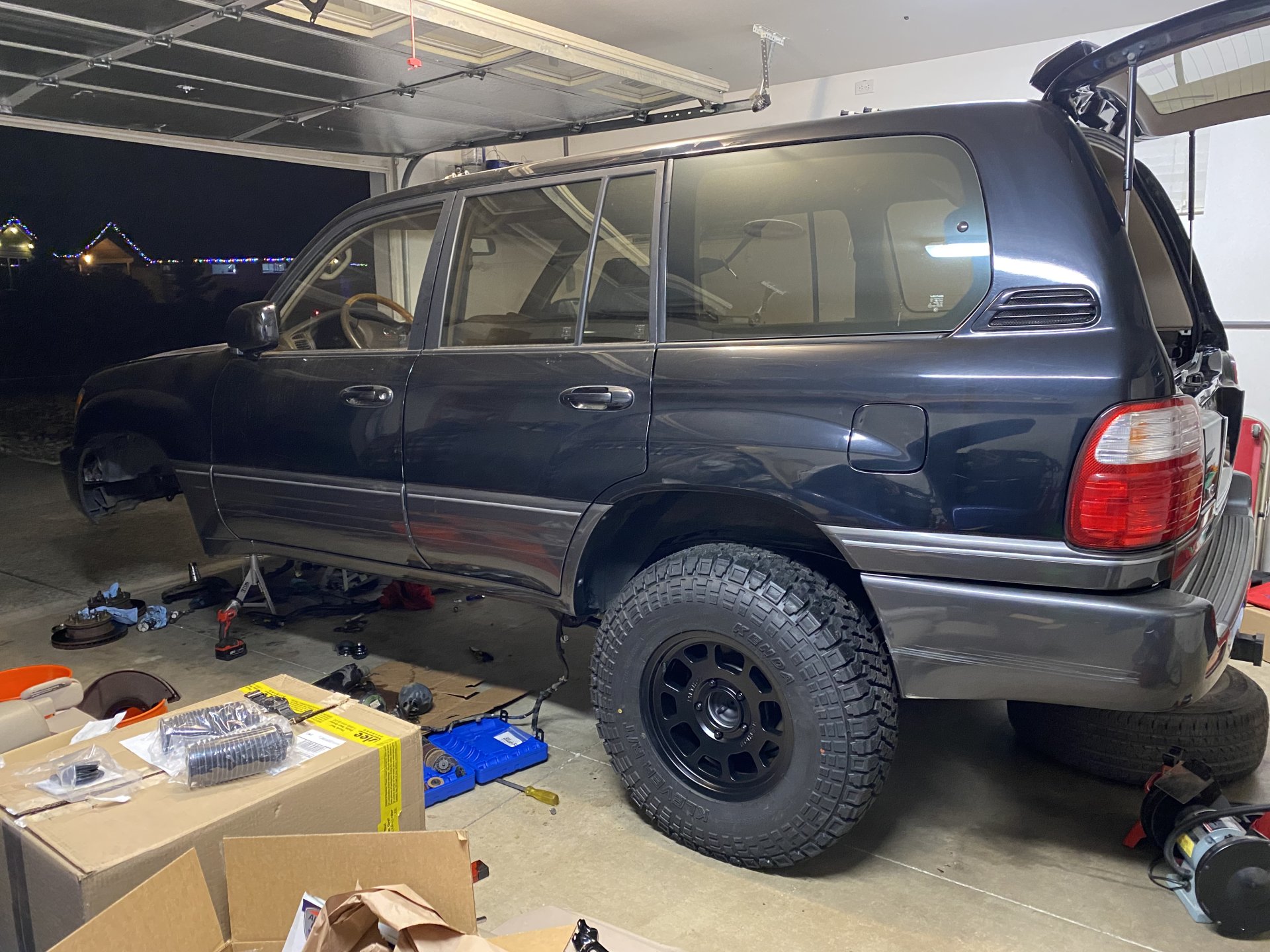

Anybody running the Method 705's yet? New trail series wheel from Method. Curious to see some shots of 17x8.5 35mm offset. Currently running Method NV's 17x8.5 0mm offset but want to reduce my offset closer to 25mm for unnecessary wear & tear. Curious about 35mm offset or wether I should go with the 18x9 25mm offset and buy a new set of tires. Love the look of my 0 offset from the PO so closer to 25 would be great just not sure its worth the extra 2k to buy a new set of tires.

I was looking for pictures of the 705 fitted as well and found this thread. The +35 is still less offset than OEM geometry would dictate for scrub radius concerns on a 200 series. For a 285/70R17 (the same tire spec'd for the RW wheels, the "ideal" offset is +50). In my mind, the only reason to go wider than that is for looks, and I imagine you'd have to be nitpicking pretty hard to tell the difference between 10mm. I certainly wouldn't buy new tires just to get that 10mm.
I hear you but I'm actually going from 0 to either 25 or 35. Not just switching 10mm. Have 25 on my 100 series and it works great. 10mm is about 4/10" so its losing either .90 inches or 1.4 inches...fairly significant adjustment in stance....and I only one to do it one time and keep it long term.
