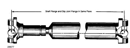

Or your driveshaft is outa ballance, out of phase, a bad u joint, or a bad angle.
I got it tight without the hubs being locked in...should they be locked when I tighten the nut? The vibration did not exist before I changed the seal, so it has to be something with the process of getting that nut back on. I cleaned and greased the u-joint...don't think that would make it unbalanced?! Well my mom and brother are in town so getting to it is on the back burnner...
drive shaft ears? what? what? did I miss something, the shaft ears go on only one way it's not square but rectangular, so they only line up one way...right? Again, It only vibrates when I decelerate...acceleration there is no problem...it's only when I lay off the gas on 4H.
Did the Splined Slip Section fall out at any point?
This is why I love being in a club...I was not aware of this...I have to check and see...they are probably not aligned...if this is it...it would be awsome...I'll keep my fingers crossed...
I took the axle off the spline, when I put it back I did not even think about lining it up...this might be my problem...
