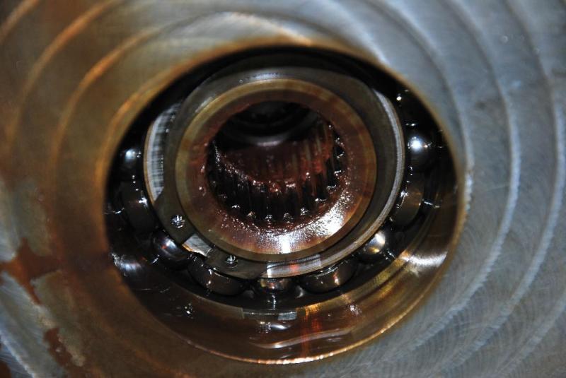

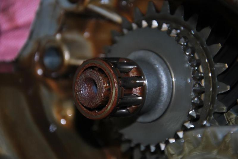

Pictures of a MC09 027 that was making noise and had a large pile of metal fines on the crawler box drain plug.
Was in an All Pro built 2004 Tacoma.
Crawler box input splines shown in picture one and two, post one appear to be fine.
