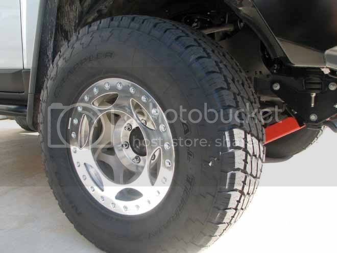

Max Tire size
Slee Offroad told me the same: 285/70/R17
I asked the good folks at Slee Offroad the same question before getting my FJ (I had the 3" OME lift installed by the dealership). They gave me a similar answer that ARB gave Toledo FJ: "285/70/R17 unless you want to get into some body trimming."
285/70/R17 -- 33x11.50 (?)

I run 285-75-16 on the factory TRD wheels but I also have a set of 305-65-17 BFG KM2 muds on steel wheels. They are almost the same heigth as the 285s but they appear a lot taller with the Krawler inspired tread. They don't rub anywhere and they look terrific.
285/70R17 is what im running and probably as big as you want to go.
A 12.5" wide tire will rub the UCA if you have the stock rims (too much backspacing).
planning on running a rim with 4 to 5 in of backspacing and a negitive offset will probabalysell stock rims
305/70R17 Nitto TG's do have some rubbing issues even with the bodymount chopped and all of the plastic mudguard suff removed. Generally you only feel it at full compression but it's still there.

Two FJ's in my club are running 35's - both have body mount trim, but no real issues (minor contact in extreme flex and turn, but thats it)
