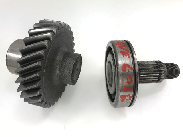

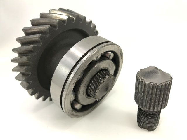

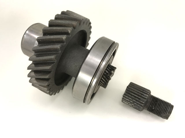

While cleaning we came across some broken factory 1979-95 gear drive t/case front output shafts Marlin had saved in a box. Out of the collection, half failed at the splines and the other half failed at the smallest cross-sectional area past the bearing race. We expect more would fail at the splines due to additional lateral forces created by the front drive shaft, but it is nice to see failures beyond the bearing at its smallest diameter.
Here is one of the factory front output shaft failures that occurred at the splines:
And here is the other failure from the smallest location beyond the bearing (smaller than the splines). The keen eye will note Marlin's handwriting of Mr. Cole. Thank you Dave for the trophy!

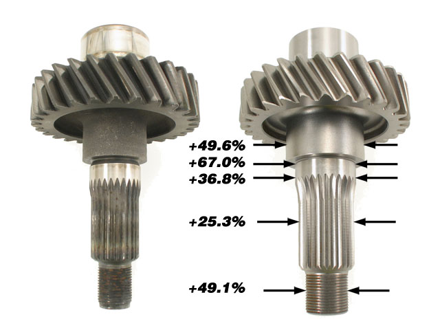

And finally, here is the Marlin Crawler Front Chromoly Output Shaft comparing cross-sectional area Vs. the factory Toyota counterpart. For all you gamers out there, this is straight-up OP:
Not only has the spline failure region increased by 25% and the minimum cross-section failure region by 67%, but we are using Chromoly steel which itself has a higher yield strength. Lights out, Game over.

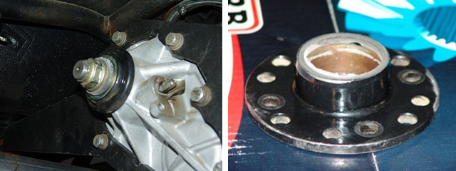

But when we began testing early HD prototypes in a Toyota V8-powered King Of The Hammers competition vehicle, we found our shafts were so strong that a factory Toyota flange could not hold up!
First time we had ever seen this! Test flange is from a 5.7-liter V8 Tundra

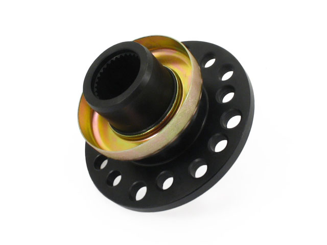

This is why we had to manufacture uber high strength flanges: Marlin Crawler oversized Chromoly outputs are that strong.
We designed these the sensible Marlin Crawler way with a 135% thicker cross-section, longer splines for maximum engagement, and a custom HD EcoSeal to boot :smokin:
