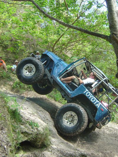

Gotta concur with Georg here.
I wheeled for years on small pattern knuckles with stock studs. Matter of fact - the pic in my avatar is from several years back, and you can see it was still SUA with 38.5 siped TSL/SX's on Stazwork double beadlocks - and I ran them at around 4lbs. The only mod to the front axle was an ARB. Broke a few birfs - but held up decent, and I hammered it pretty good (making all of the trails at Tellico, except Peckerwood, without winching - might roll, might break an axle, but made them all at some point and time). Ran them for one year with 4x4 labs high steer - and only broke a few studs, and was able to limp back to camp each time.
Upgraded when I went to 39" Krawlers - which has caused all sorts of carnage, helping to find just about every weak spot I have in my setup.
I definitely wheel harder with the six shooters - but you can wheel pretty damn hard with stock knuckles if you have your krap set up right and drive decent.
Added a couple of pix of some folks who wheeled with stock large pattern - the first SUA with 39.5 Boggers (he did better when he bought my TSLs) and a SOA on 40" MTRs - both locked, the latter with Ram assist. They wheeled stupid at times and did fine...
