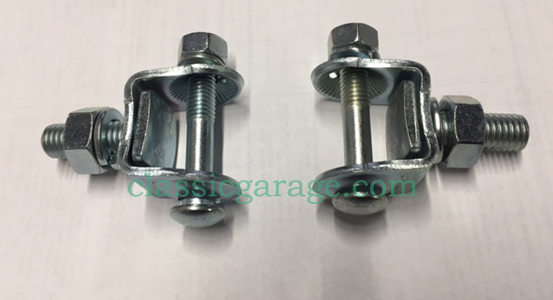

The brackets I refer to are the ones that comes with the Hella 500 lights I installed. They look like this:

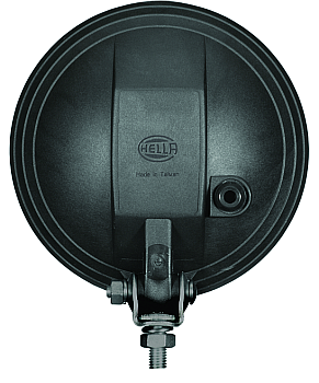

Normally, the light housing has a plastic boss at the bottom through which the long thinner screws on the pictured bracket pass like this:
The shorter thicker screw goes into your bumper or rack or whatever you mount to and secures with the pictured washer+nut. In my case, I reversed the orientation of the thicker screw and changed it to a stainless countersunk screw and fed it up into the bracket. In other words, the nut sits within the bracket, not outside the bracket as you see in the photo.

Thanks, that is exactly what I was asking.
