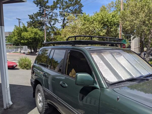

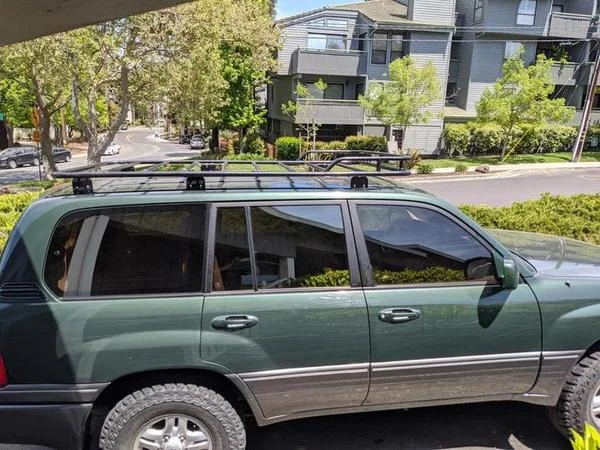

so I was hoping to get the combined wisdom of the Mud community to here to help me figure something out.
I have a rack from Trail Tailor that I love. As you can see, it has the kind of expo style basket in the front.

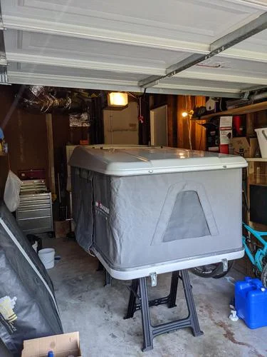

I just bought a lightly used Small Maggiolina Extreme hard shell tent that I'd like to mount on it. Here it is:
However, the top shell on the tent is sliiightly too wide to fit the basket on the front of my rack. But the bottom shell fits just fine. Here, I even drew a professional diagram.
Looking from front of vehicle:
The red circles are basically where the two mounting rails are for the tent. I only need about 1.5" of lift from the base of the rack so what I'm thinking is find something that runs the length of the mounting rail like a 2x2 block of plastic that is long enough.
My questions are:
1) Has anyone encountered this and raised up one of these tents like I'm trying to do?
2) If I do raise the tent up, should I do so under the metal mounting rails of the tent? I'm kind of worried about all the weight resting on those two skinny rails...
3) Any ideas on what I could put in there as a spacer?
4) Any other ideas?
2x4s are cheap and would actually be about the 1.5 inch thickness you need. Just use a few pieces lengthwise to hlep spread the weight, some crossways, that would require less material.
Ah forgot to update this thread
Last weekend I chopped the top bars off my rack, grinded, sanded, painted. Then cut lengths of garden hose to pad the tent against the rack. It fits like a glove!
