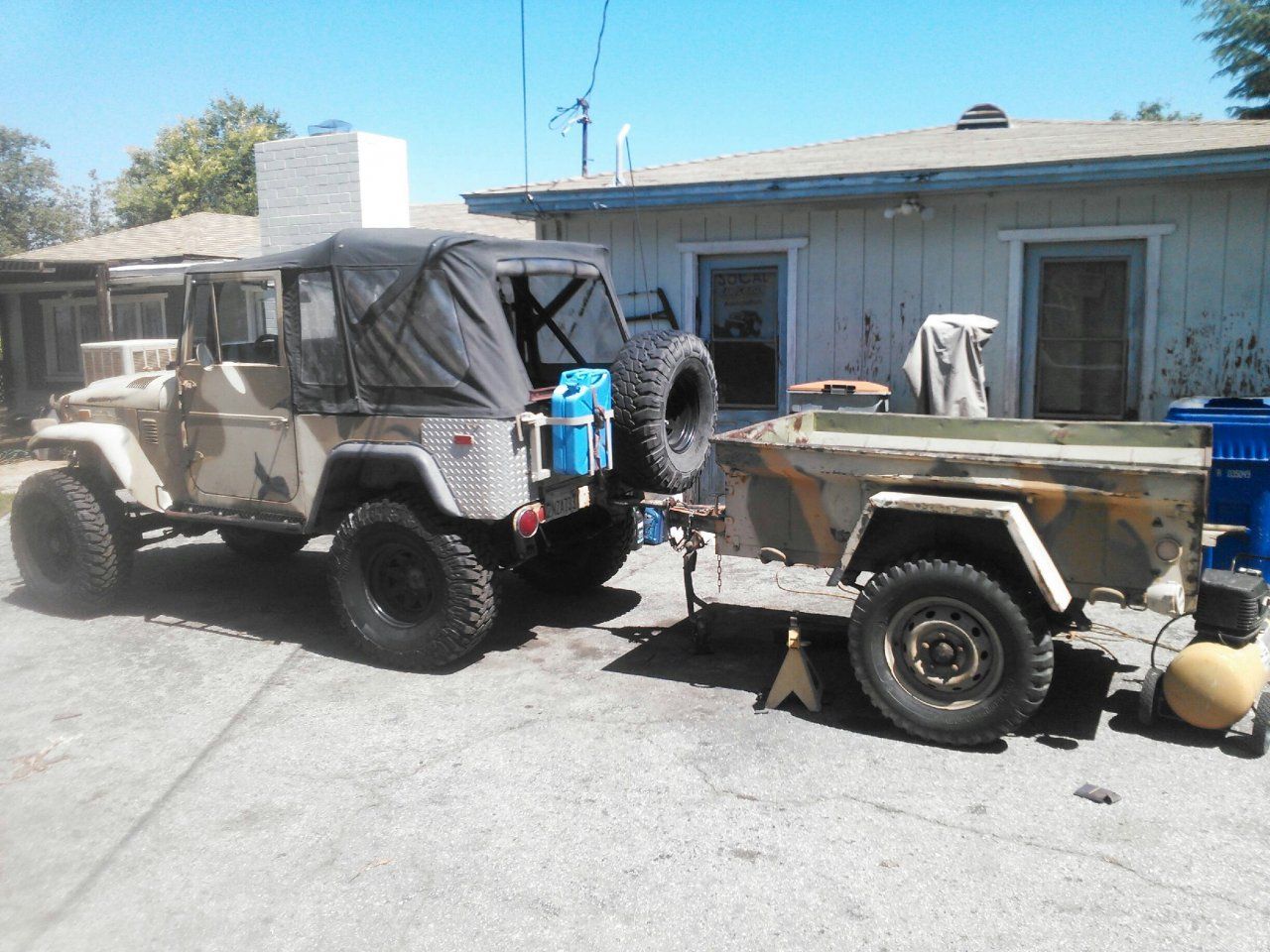

Thanks John, yeah I got new inner tubes installed and repacked the wheel bearings. Checking into new springs next week then build some brackets for the ARB roof top tent
Rob I was able to install a FJ60 spare tire carrier using the front to holes in the front spring perches and shimming the other bolts to match and drive two holes in the frame. I'm using one of the original rim/tires as spare. You run anything bigger I doubt it would work with the folding leg.
