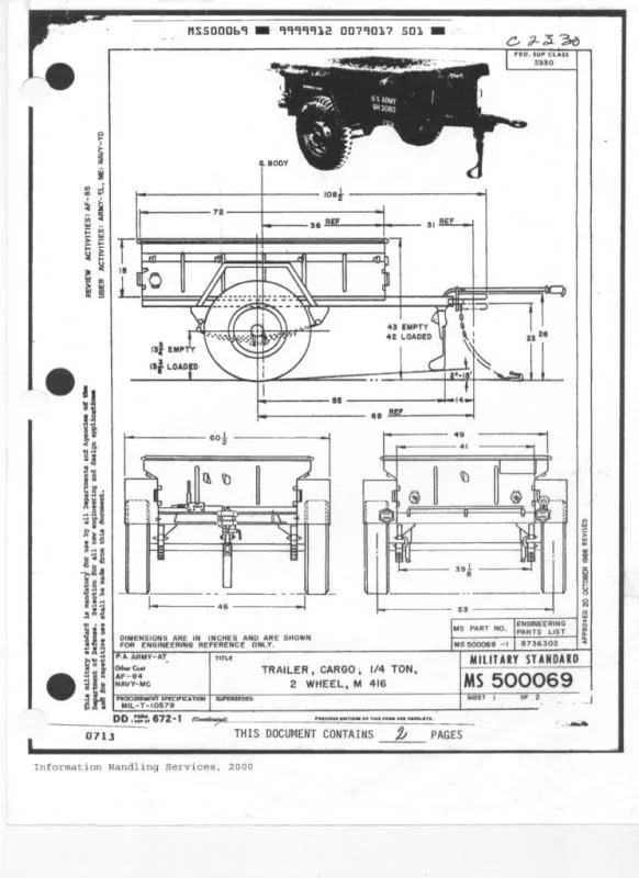

M416 dimension's specs??
M416 Specs
This is the best I have found yet on the net. I am looking for someone that has drawn up some detailed CAD or other spec sheet.
TC
Full manual here...forgot where I found it but saved it for future reference.
