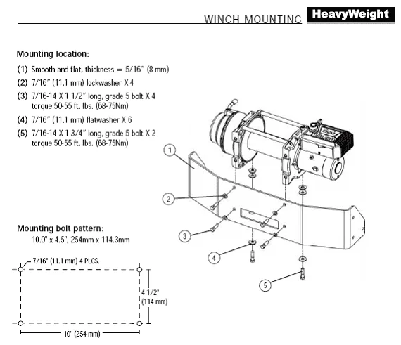

I happen to have that info...
You may know already that the M12000 is strong enough and its mounting body parts soft enough that it has to be mounted feet forward (or buttressed upfront as is sometimes claimed), as discussed here plenty and also as shown in that drawing above. For some strange reason, lots of folks are not aware of that or don't bother, and obviously you could seriously damage the winch if you don't mount it properly.
