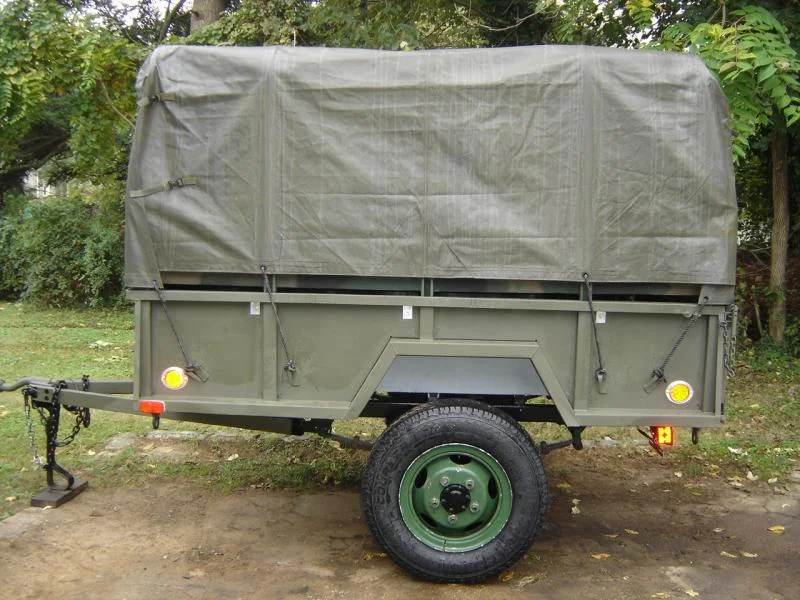

Greeting everyone, i have question to all of you trailer guru. I just bought M101 trailer and planning on replacing my old 9.00-16 military tires because it is dry rotted and has two nails on both tires. My question is, is it possible/safe to mount regular street tires instead of military tire on split rims that M101 has. I notice that one of the member has M101 with 235-85-16 tires on it.I am going to tow this trailer with my fzj80 from Md to Seattle-Wa on the next two months, so safety is really my big concern here. I thank you all very much in advance for any help and greatly appreciate it.:cheers:

Thanks for all the advice guys:cheers: after three tire shop and three truck stop, i finally found truck tire shop in Glen Burnie who really know and have experience with old split rims and tube tire. It cost me $380 for tires,tubes,mount and balance. The tire that i used are Mastercraft Corsair LTR 235-85-16. So to all of you who have split rims, it is safe to put street tire on it as long as you mount the tube & tire properly. The name of the shop is Gillete Tire Distributors,Inc. it is located on 112 Roesler Road, Glen Burnie,MD-21060 [410-766-2190] the owner is knowledgeable and great person to deal with.

Nice looking trailer. I am kind of astounded that it was necessary to print FRONT on the cover to make sure it was applied correctly though...
:rolleyes:
I guess not everybody grew up watching Combat! reruns.:popcorn:
:rolleyes:
